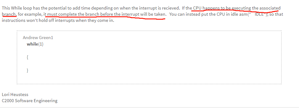

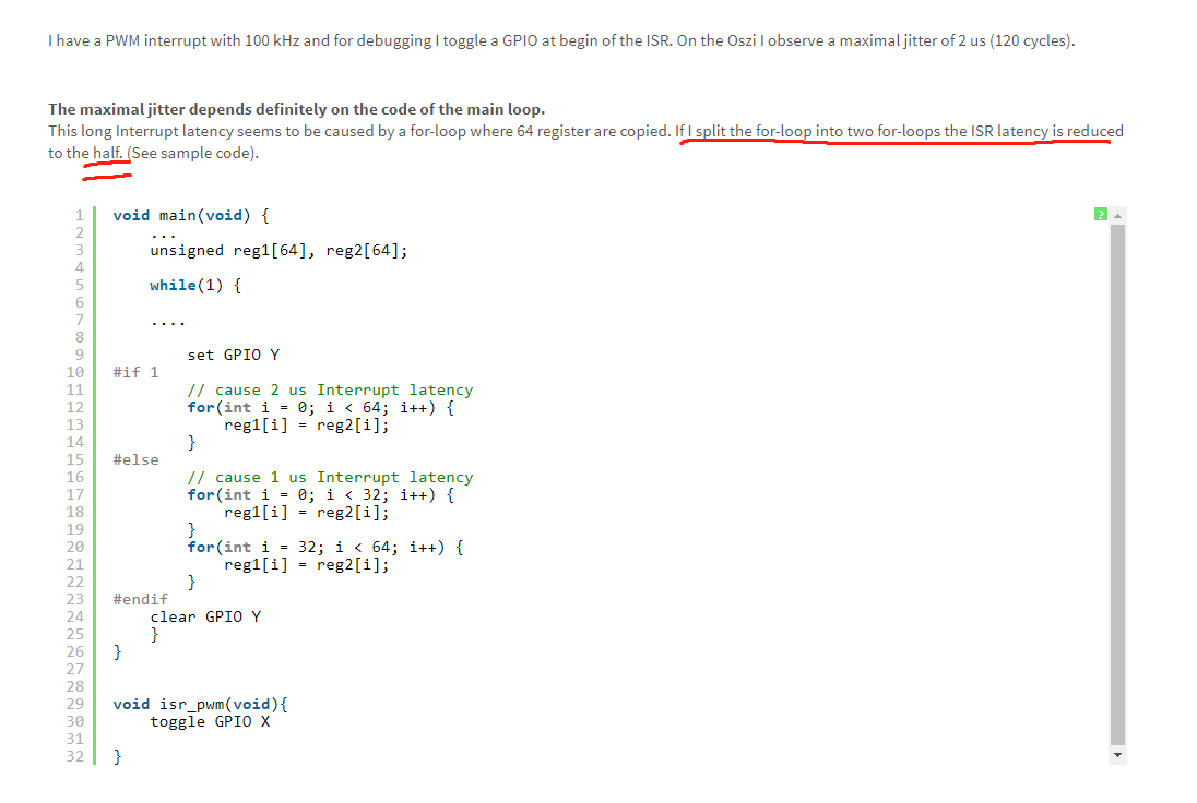

I am puzzled by the interruption delay,with a  search then i found this two below posts. According to my understanding,it means for loop cannot be interrupted,  it must complete the branch before the interrupt will be taken.  If I understand right, Is there a high probability of interrupt delay if loop in main code?

  • There will always be some interrupt latency, whether the interrupt takes place inside a 'for' loop or not. This is true for any MCU. In the first post you referenced the issue appeared to be related to interrupt payload. In the second, code execution from (slower) flash memory was involved.  Neither issue was caused by the presence of a for loop.
    It is not true that a 'for' loop cannot be interrupted. Certain instructions, such as the RPT instruction mentioned in the first post, are non-interruptible, but they are not related to the loop.
    Richard
