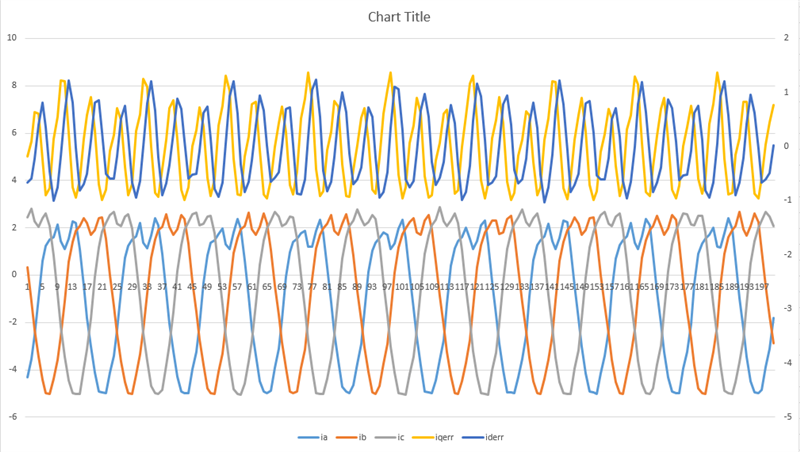

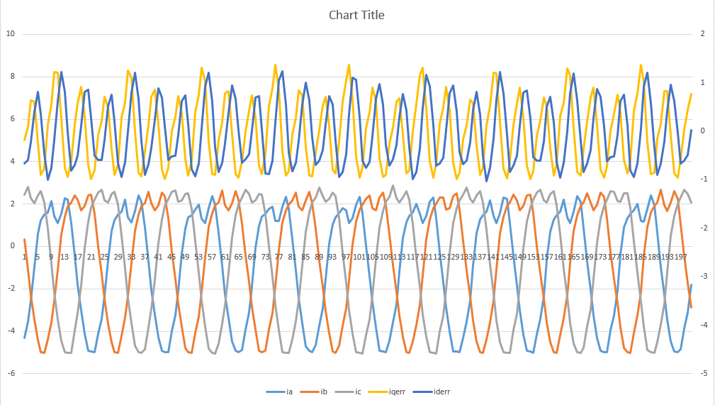

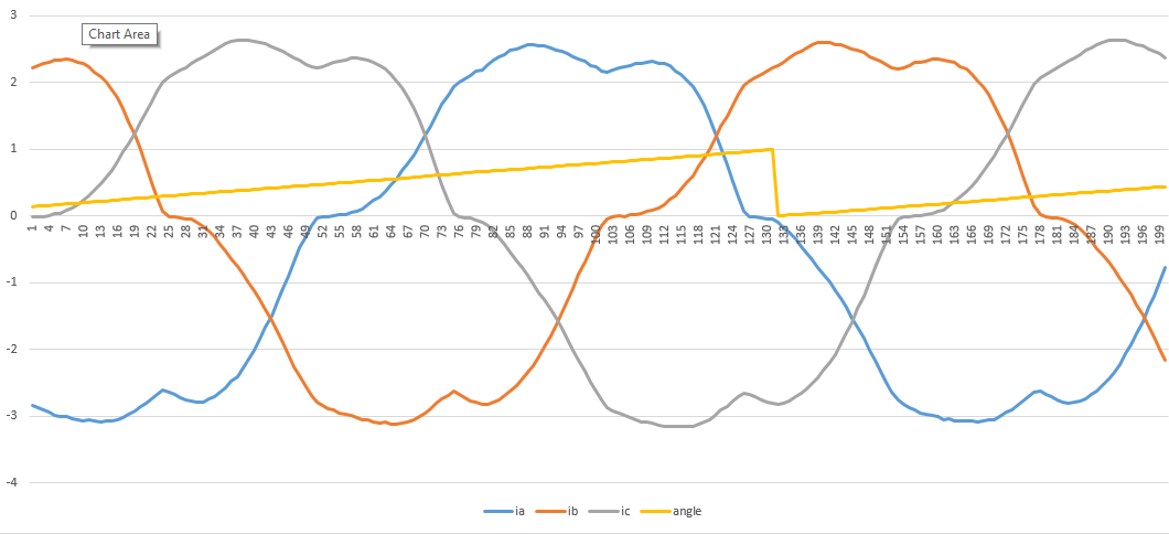

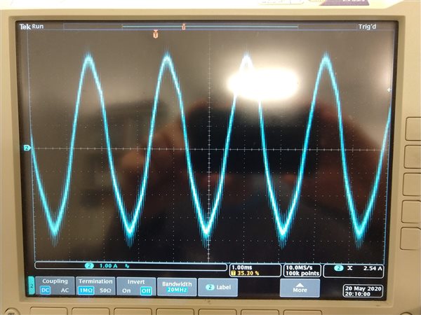

I'm trying to drive a BLDC fan motor using InstaSpin-FOC.  It seems to mostly work, but at high speed and torque I get waveforms like in the above scope capture which are pinched at the bottom.  Is that normal, or what can I do about it?
Then also, and probably more importantly, the other plot shows how at high speed (torque doesn't matter) I get a large offset in the reported current feedback.  I have about 0.25A in the positive and 1.5A in the negative.  Putting a current clamp on the phase to the motor I see at most a 20% offset from zero, something like 0.5A one way and 0.6A the other.
I'm sure I haven't provided enough information, so let me know what you need and I'll post it.  Thanks!
  • You might try something as below.
    1. Calibrate the current and voltage sensing circuit to improve the sampling resolution.
    2. Tune the Gains of the speed controller.
    3. Identify the motor parameters of each board and motor separately.
    3. Check if there is an overflow of current sensing.

  • The waveform should be normal if you make sure that the current & voltage offset and sensing signals are well and the motor parameters are identified correctly. 1. You might check what's the USER_MAX_VS_MAG_PU in user.h, and if the gMotorVars.Vs is equal to the USER_MAX_VS_MAG_PU when the motor is running with high speed.
    2. What's the high speed (electrical frequency) you tested? What's the USER_VOLTAGE_FILTER_POLE_Hz? Do you have the BEMF data of the motor from its manufacturer?

    1. USER_MAX_VS_MAG_PU is set to 1.15.  On one run that was going about 80% of our max speed of 7000rpm the Vs was between 0.7955 and 0.8233.  I can do that again at 100% speed to see if it gets up to 1.15.
    2. We're running at 7000rpm on a 8 poll (4 poll pair) motor, so the electrical frequency ought to be 466Hz I believe.  The USER_VOLTAGE_FILTER_POLE_Hz is set to 970.78.  I just spent some time talking to our EE who says the latest rev board took that filter out all together so is suggesting I turn up the pole number to something very large.  Do you agree?  I need to confirm but I have a datasheet that says the Back EMF is 29.4V / krpm.

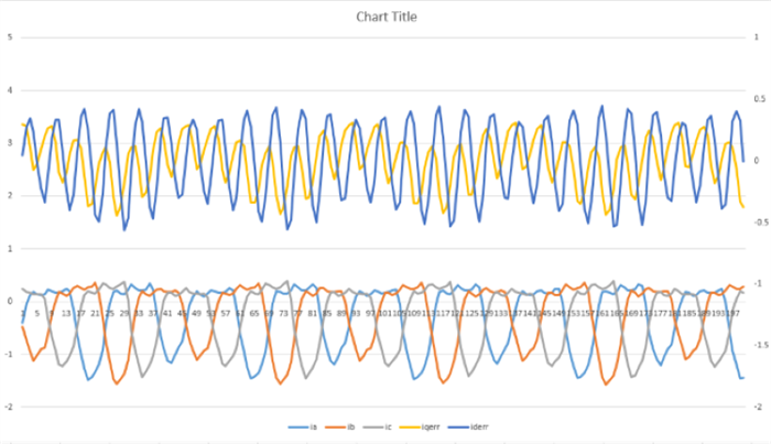

    I will add another plot that shows our current feedback looking ok at high torque / low speed.

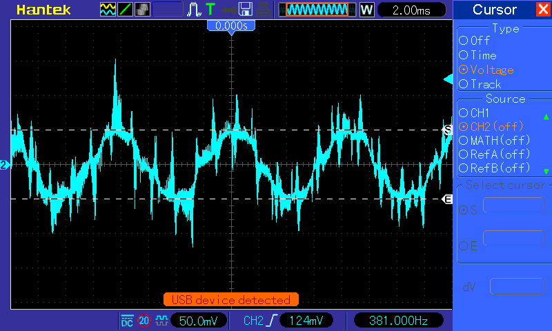

  • Hi Jacob,
    I have asked about the same inflections occurring in the current and received no logical explanation. Off hand your above capture appears as if a phase margin error exists in PWM duty cycle being out of synchronization with one or both Clarke inputs.
    That seemingly occurs from fact inductive current lags 90° behind VEMF and must be compensated for. Since FAST module is so secretive "little to no technical brief" it would seem it (TI example code) does not compensate for the inductive current lag causing distorted sine waves. One option is to simulate the BLDC via Matlab models of FAST estimator, Clarke/Park transforms in order to reveal or determine reason for current distortion. Perhaps TI has these models available for Matlab simulation of the older MCU classes.
    Alternatively you can experiment with SOC triggers and interrupt decimation times to see if that improves things.

    Yes, it seems like the 466Hz electrical frequency is not too high for InstaSPIN. The over-modulation and current reconstruction are not implemented since the voltage vector magnitude is lower than _IQ(1.0), so the current sensing may not be the issue for the high speed of your motor.
    1. You might change the voltage sensing circuit and ensure the voltage filter pole frequency is between 600Hz and 800Hz which should be fine for your motor.
    2. There is a software filter for the speed estimate, which is currently set to 100 rad/s (USER_SPEED_POLE_rps) by default. You might change that the value to 300 rad/s, even try 500 rad/s or 1000 rad/s.

    Yet how do you explain the same odd current distortion below capture occurs at much lower speeds 150Hz via new SDK and BoostXl-drv8320rs default filer pole settings? The inductive phase current angle is clearly not in phase with PWM drive causing notched current distortion. Clarke is obviously problematic since motor control suite days. Using PWM module to SOC trigger Ia,Ib,Ic samples seemingly is occurring after the fact, missing RMS peaks and creating notched offsets. It strikes me odd Clarke emf (Va,Vb,Vc) has same SOC trigger source as current (Ia,Ib,Ic) when electrical theory states inductive current lags voltage by 90°. It would seem the SW has timing issues that must be addressed well before customers can have precision results.
  • OK, so our EE removed some filtering on the op amp for the current feedback which had caused a reduced gain at higher currents.  Between that and whatever other fiddling I've been doing in the code the offset on the current feedback has gone away.  The EE says he can't see how removing that filtering would induce an offset, but I can't see how my code changes would either.  If it makes sense to you please explain.
    So now I'm left with the crummy wave form to fix and it's still an issue.  I've moved to another motor and I'll try posting the latest waveform for you to look at here soon.

  • Sanity check question: if I set the Iq_ref to 1A, am I going to see 1A output on the phase peak to peak, or is that from 0 to peak?  The scope catpure below is with Iq_ref set to 1A, and the output is 1A peak to peak, is that right?

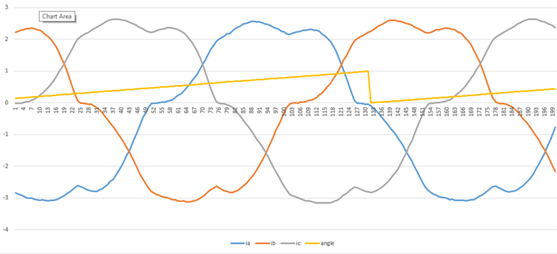

  • Here is my latest.  You see the phase current has a kind of pointy bottom side, and there's a strange right hand shoulder on the upper side.
    Then in the plot below you can see there's still an offset in the phase current feedbacks, and a messy top to them.  Is that normal?
    I'm really confused by the current feedback scaling.  When I run the calc from section 5.2.1 in the manual I think USER_ADC_FULL_SCALE_CURRENT_A should be set to 21.2.  But then my output is 1A peak to peak when Iq_ref is 1, and I think it's supposed to be 1A zero to peak, right?  Also the motor doesn't run as well with that value.  So I set it to 10.6, the motor works better, and I get 1A output zero to peak.
    For the equation my values are:
    • Rshunt = 0.05
    • Rfbk = 30,100
    • Rin = 10,000
    So for Vout of 3.3 Iin should be (3.3-1.65) / Rshunt * Rin/Rfbk = 10.6.  That's in the positive direction, so you double to get the full range and it should be 21.2, right?
  • Hi Jacob,
    You can get a higher phase current accordingly if the reference torque current is set to a higher value, but there is not a constant proportion between these two values.
    The top waveform captured by the oscilloscope seems good, but the feedback signals in the bottom figure are not correct. It's very strange, I don't think the phase current waveform of the motor will be so good as the top waveform if the controller uses the bottom feedback signals. Do you have any chance to use DAC or PWMDAC to check the feedback signals?
    The USER_ADC_FULL_SCALE_CURRENT_A should be the full range of the ADC, so it is 3.3/Rshun/(Rfbk/Rin)=21.9269(A).
    That depends on what the motor feed back looks like when you spin it by other means, does it produce symmetric waves? But yea agree it looks like the 3rd harmonic is not being detected or injected. NXP has nice Matlab informative as to 3rd harmonic benefits of AC current peak symmetric +/-AMax. Otherwise some kind of harmonic distortion seems to be present on newer motor. Have you tried another current monitor such as INA240 to verify if the the distortion is due to amplifier/shunt selection issues?
    You can attach INA240 vertical sub PCB placed directly above shunts via 2 gold plated pins formed outward and solder to edge of each shunt. The 240 does produce a very clean sinusoidal wave form and added bonus of PWM rejection. Perhaps even try one sub PCB just to compare the difference.
