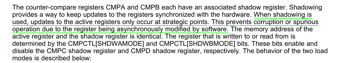

The introduction of the fast current loop mentions the pwm immediate update mode, does this refer to CMPCTL [SHDWAMODE] = 1.
In this case, will it cause pwm update confusion, as mentioned in the figure below
  • When using immediate mode, you have to be more careful about when you write to the registers. Pick a safe spot where the value in your CMPs are not being used and then update them then.
    Nima
