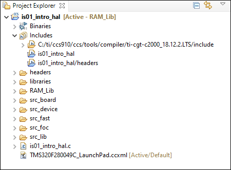

Your Project Explorer should look like this:

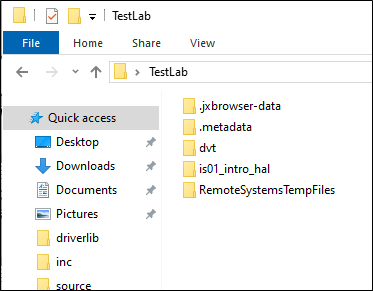

…your Workspace should look like this:

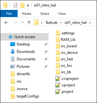

…and your project directory should look like this:

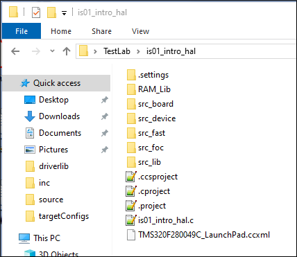

2.  We’re going to start with the three files in the project root in Project Explorer. You can tell from its icon that is01_intro_hal.js is an unresolved link. I can’t find this anywhere in the C2000Ware installation, so I just deleted it in Project Explorer. You’ll notice that the other two files are linked resources. In Project Explorer, highlight and copy them. Now go to your project folder (remember…this is the one you access using Windows Explorer or whatever directory navigator you like to use) and paste them. Your project folder should now look like this:
3.  Back in Project Explorer, delete the two remaining files. They will reappear shortly. If not, try refreshing the list in CCS. Your Project Explorer should now look like this. Notice that the two resources are no longer linked.
4.  Repeat the above steps to copy the files and delete the links in src_board, src_fast, and src_foc to the corresponding locations in your project directory.

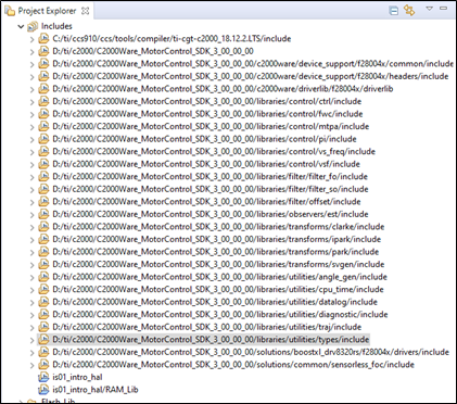

8.  The whole point here is to eliminate all references to the Ti filesystem. If you open the includes folder in the Project Explorer, you’ll see a TON of paths in the Ti filesysem, and a few others:
We’re keeping the CCS path because that’s not part of C2000Ware (and we need it for the standard libraries), and we’re keeping the two paths to our project directories. We need to add the header directories. In the main menu, go to Project->Properties. Under Build->C2000 Compiler->Include Options, add the header directory (or directories).
