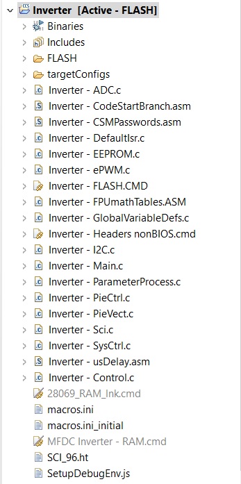

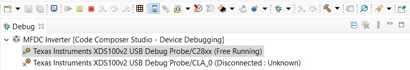

Hello all,
I have created a program which is communicating with an E²PROM via I²C and PC via SCI. When Launchxl is first energized, it reads from E²PROM and writes the values to my parameters. Then with my pc interface, I can read these values or change these (write to Launchxl).
But this only works on debug mode perfectly.
When I does not start debug mode via ccs and only conect Launchxl to pc's usb, as I understand, sci is not working. But other functions are ok. Eeprom is answering the attend, launchxl gets the retentive values, I can even trigger ePWM.
Sci signal is being received but Launchxl does not understand the command.
I cannot always start the debug mode. As I understand, my FLASH map is not included sci. I could not understand that part good enough actually.
My FLASH map is given below.

It is a modified version of F28069.cmd. The normal F28069.cmd does not work properly for me but this one was perfect except sci.
I have checked Example_2806xFlash, Example_2806xFlashProgramming, f28069_sci_flash_kernel but could understand their purpuse or if they are related.
What should I do exactly? If I should give more details, lead me, please.
Thank you.

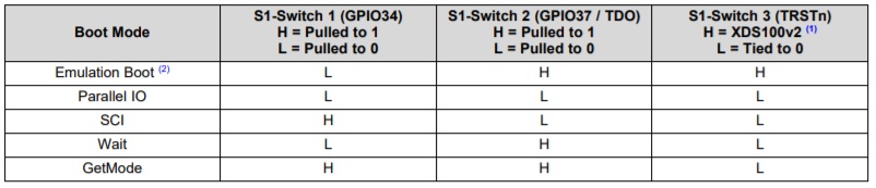

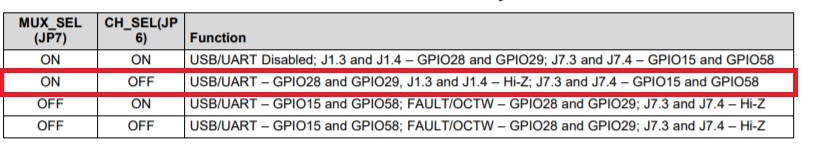

P.S : S1 DIP switches are all 1 (H) on LaunchXL-F28069M. JP6 is not connected and JP7 is connected. I have worked that way until now.
  • Hi Troodon,
    Depending on your application code you may need to copy the SCI functions and ISRs from Flash to RAM and configure them properly to run from RAM. Please see the post below for more info:
    https://e2e.ti.com/support/microcontrollers/c2000/f/171/t/758797
    Kevin

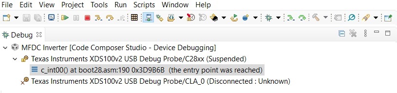

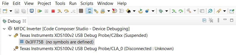

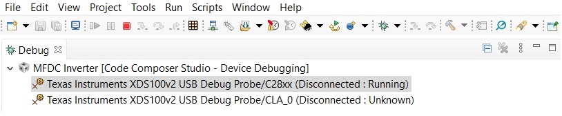

  • Hello Kevin,
    Thank you for your answer.
    I think I have done quite much about "Running an Application from Internal Flash Memory" but maybe I am missing something.
    I have changed my cmd files. Cmd files and usDelay.asm file are now as below.

    Ok I will ask step by step.
    Lets say I started a debug mode. Program works perfectly that way.
    Then I removed the usb cable of LaunchXL. The debugger status would be like this.
    I reinserted the usb cable. Then clicked on "Connect Target".
    It said 0x3FF75B (no symbols are defined) and when I pressed F5 or F6 to see a progression step by step, adresses changed and finally it passed to CodeStartBranch.asm
    wd_disable:
        SETC OBJMODE        ;Set OBJMODE for 28x object code
        EALLOW              ;Enable EALLOW protected register access
        MOVZ DP, #7029h>>6  ;Set data page for WDCR register
        MOV @7029h, #0068h  ;Set WDDIS bit in WDCR to disable WD
        EDIS                ;Disable EALLOW protected register access
        LB _c_int00         ;Branch to start of boot.asm in RTS library
        .endif
    ;end wd_disable
    And then boot28.asm. There is a loop over there that goes on.
    LOOP:
    	MOVB    AH,#0		        ; zero out upper addr bits
    	PREAD   AL,*XAR7		; load address of variable to be inited
    	ADDB    XAR7,#1			; point to initialization data
           	B	GET_DATA,NTC	        ; get data if variable is not far
    	CLRC    TC		        ; reset TC bit used as far flag
    	PREAD   AH,*XAR7	        ; otherwise, get hi bits of 22-bit addr
    	ADDB    XAR7,#1
    GET_DATA:
    	MOVL	XAR6,ACC	        ; address
    	RPT	AR1			; repeat length + 1 times
    ||	PREAD   *XAR6++,*XAR7		; copy data from table to memory
    	MOVL	ACC,XAR7		; using ACC as temp, point XAR7 to
    	ADD  	ACC,AR1			; next cinit record since PREAD
    	ADDB	ACC,#1			; doesn't change value of XAR7.
    	MOVL	XAR7,ACC
    START:
    	PREAD	AL,*XAR7		; load length
    	B	GET_ADDR,GEQ	        ; a length < 0 denotes far data
            NEG     AL		        ; negate value to get real length
    	SETC    TC		        ; flag that the address field is 32-bits
    GET_ADDR:
    	MOVZ	AR1,AL		        ; copy length value to loop register
            ADDB    XAR7,#1			; point to address field
    	BANZ	LOOP,AR1--		; if (length-- != 0) continue
    Unless I press the F8 (Resume) button, that loop goes on forever. If I press F8, sci works perfectly.
    I think that is what happened when I only energize LaunchXL without connecting CCS debug mode?
    Any idea what is going on over here?

  • Hello Kevin,
    Project explorer screenshot is given below.
    F2806x_CodeStartBranch.asm is also given below.

    I checked the boot mode pin states in the device datasheet:
    3 DIP switches are all H.
