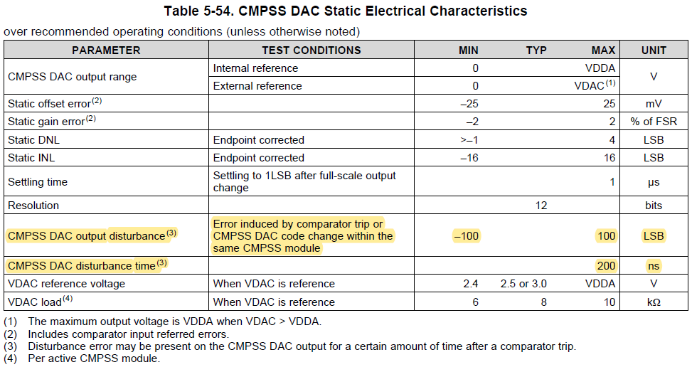

Hi Expert,
I'd like to make sure that if COMPH and COMPL in a same CMPSS module could work as two separately comparator parts, in other word, if the CMPx_HP and CMPx_LP could connect different signals at the same time?
However, in F280049 TRM, it seems CMPx_HP, CMPx_HN, CMPx_LP, CMPx_LN are connect with a same pin.
Could you help to comment this? Thanks!
Hi Tommy,
Do you mean that "CMPSS DAC output" is connected with negative input of the comparator, when trip occurs or DAC value changes, the negative reference voltage value will be disturbance in -100 to 100LSB range?
Best Regards
Rayna
Rayne,
That is correct. COMPDACH and COMPDACL share some components so a trip or change on one will induce disturbance on the other. This means if COMPH trips or COMPDACH's value is changed, it will temporarily disturb COMPDACL's output for a max time of 200ns with max magnitude of -/+100LSBs.
