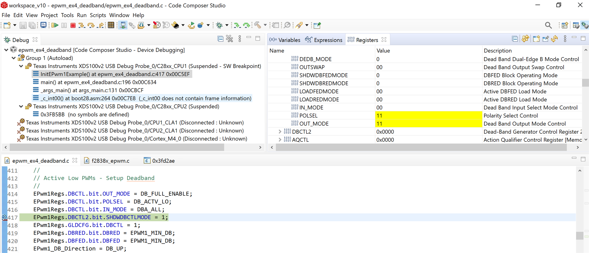

My customer would like to shadow load DBCTL settings. They find contents in DBCTL will be cleared when configuring SHDWDBCTLMODE in below sequence. I can also reproduce it easily wtih example project epwm_ex4_deadband by adding only two lines of code.
Below two lines are what I am adding:
EPwm1Regs.DBCTL2.bit.SHDWDBCTLMODE = 1;
EPwm1Regs.GLDCFG.bit.DBCTL = 1;
Step one screen shoot, you can see DBCTL is correctly configured here.

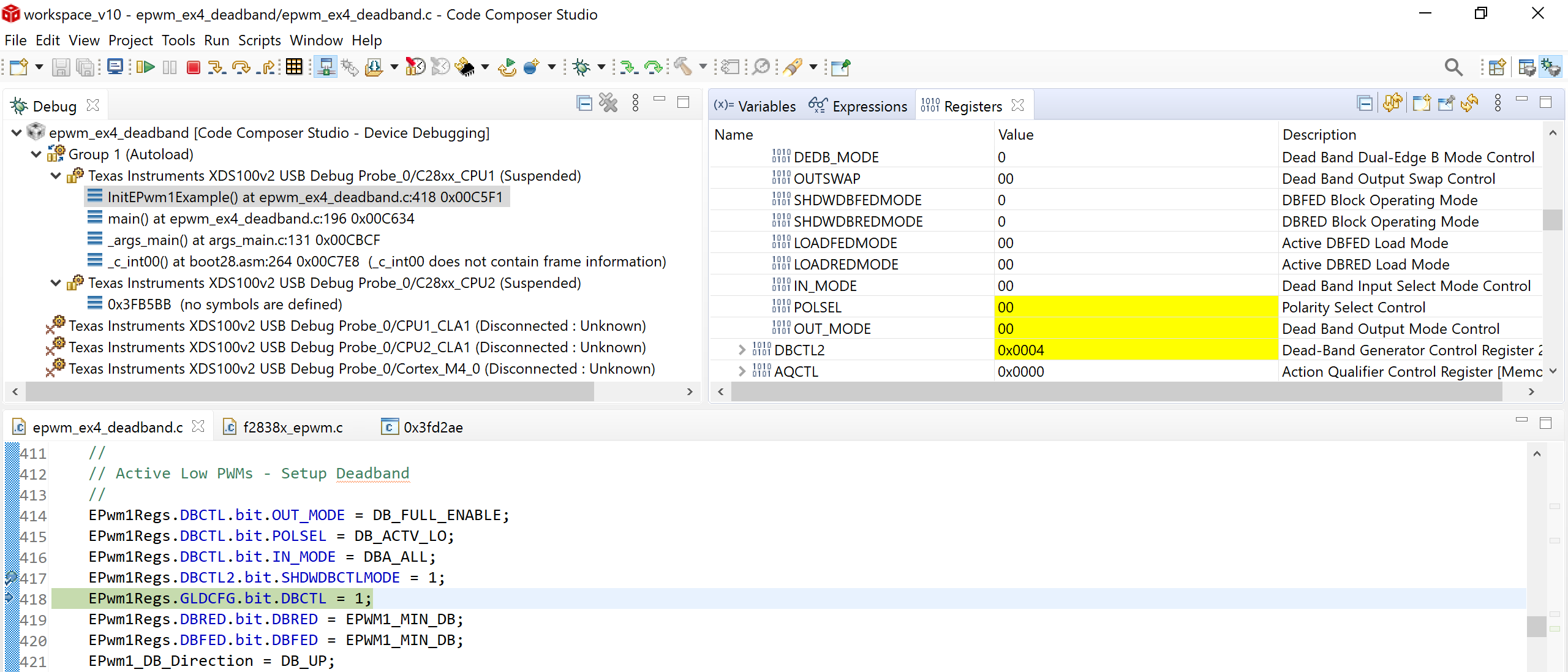

Step two, after step into line 417, contents in DBCTL is cleared.
I didn't see explicit requirements on sequence of configuring these two registers. So could you help me confirm on why this happens?
