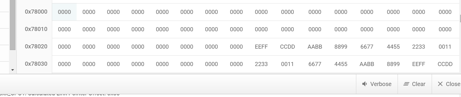

The associated release build .hex file was successfully flashed into the processor, or at leas that is what UniFlash told me.  But afterwards, I can no longer unlock the processor, using the designated passwords (00112233, 44556677, 8899aabb, ccddeeff ).
I can see that the link pointer location was changed to 0x78030, as desired, and accomplished by setting the 3 LINK POINTER values to 0x1ffffffe.  And it looks like the related Zone Select Block values there are the ones I programmed in.  But again, I cannot unlock the processor, using the designated password values.
Please advise,
Robert
  • Hi Robert,
    How are you providing the password values to unlock it ? Can you post a snapshot of the same.
    Vivek Singh
  • Hi, thanks.  Doing it via the UniFlash too.  After a previous firmware download, I was able to use this method/location for entering the passwords, for lock/unlock.  And I thought the latest firmware had the same passwords.  But yet, no luck
  • I investigated the zone select blocks, by doing a data read in UniFlash, at the old one 0x70020, and the new at 0x70030.  And the passwords were swapped in the locations.  Once entering it in, in the new format, I was able to unlock.  But I still cannot load via JTAG, so will leave this open for more assistance.
    Robert

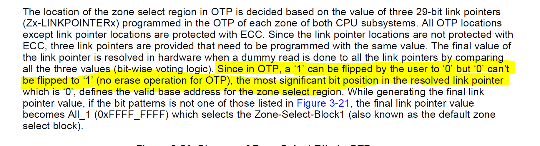

    You are programming below value for LINKPOINTER
    .sect "dcsm_otp_z1_linkpointer"
    .retain
    .long 0x1FFFFFFD
    .long 0xFFFFFFFF ;Reserved
    .long 0x1FFFFFFD
    .long 0x1FFFFFFD
    This is not correct. As I mentioned in other post, you can only program bit value '1' to '0' but can not program '0' to '1'. Value D means 0x1101. Assuming you have already programmed bit position 0 as '0', now you are trying to program it '1' which is no allowed. You can program it to either 0xC or 0x8.
    Please see below snapshot from TRM (section "3.13.1.5 Link Pointer and Zone Select")
    Please correct this and that should fix the issue.
    Vivek Singh
  • Yes, thank you, it now flashes.  I read that many times in TRM, but now have the context to understand it.  Maybe some future update of the documentation can add this type of an example, to give the reader better understanding.
