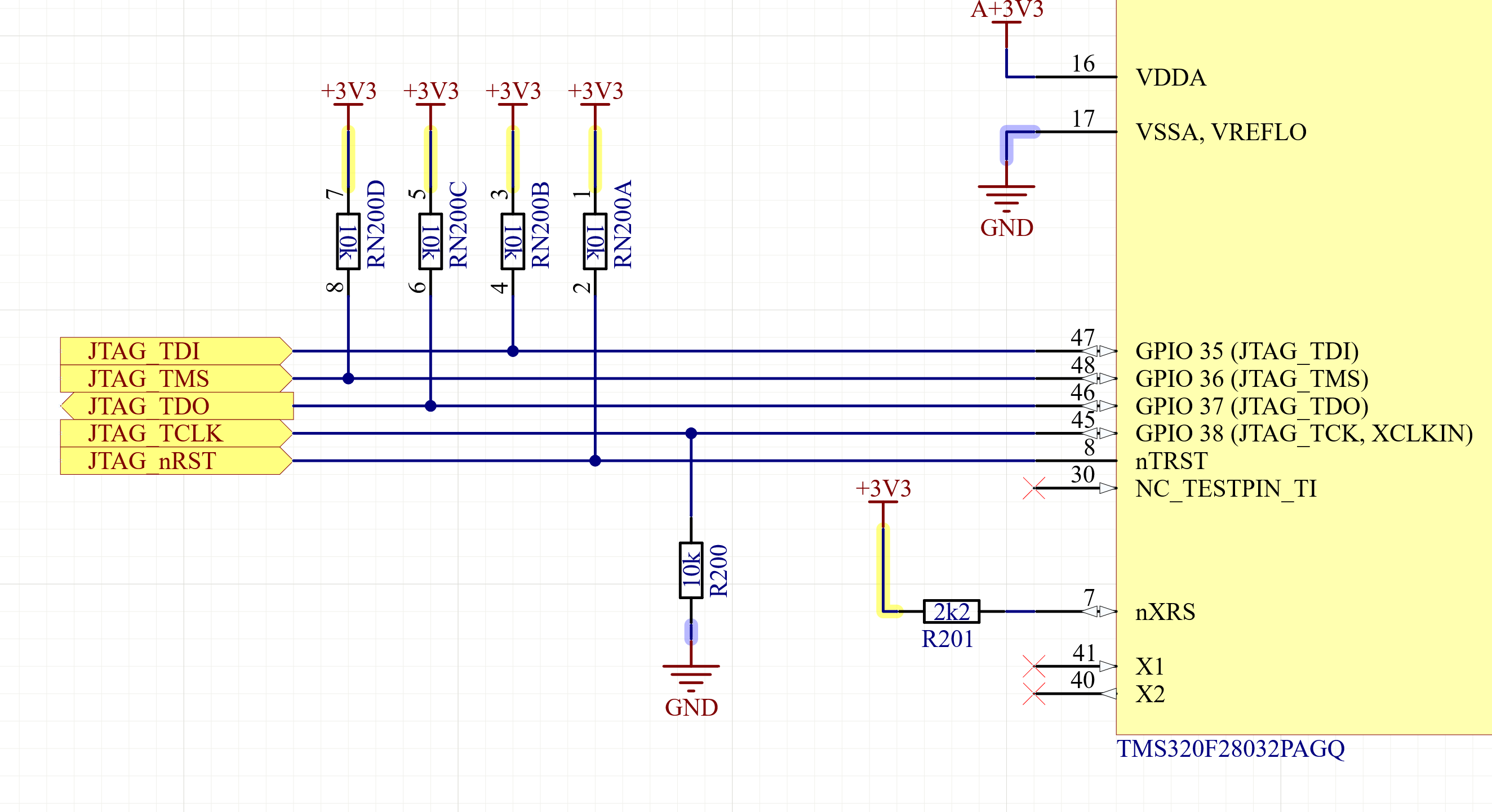

  • Here is my jtag pin 10 pinout:
    And here the XRS pin:

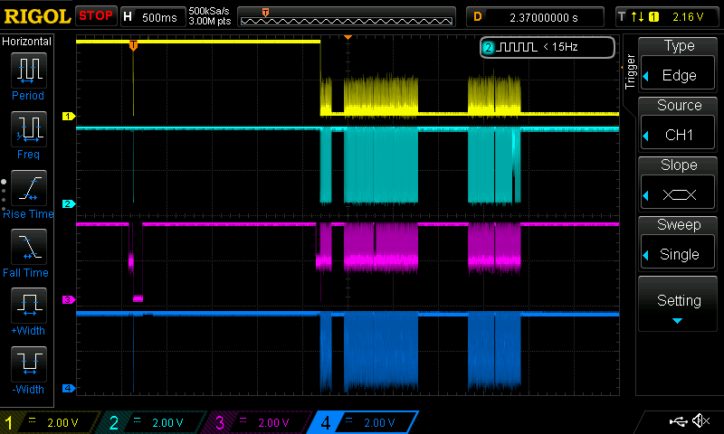

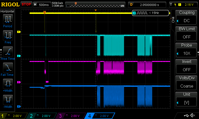

    so I found out, that on the 20-pin to 10-pin adapter you can change one Zero Ohm Jumper, and now the TRST pin is routed through pin 10.
    Now I see the reset line toggling. But, unfortunately it is still not working... I see, definitely a reset toggle on the reset line, but why is CCS complaining, that device is holded in reset ? And still the question: Why is the Test Connection working successfully, but debugging/loading program is not possible?

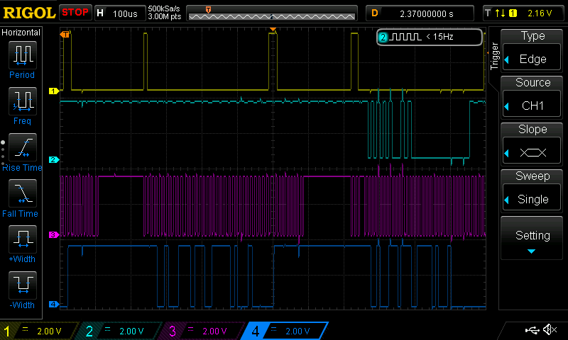

    I attached you screenshots from oscilloscope from all JTAG lines. For me nothing suspicious is seen here. (The first two pictures, yellow line is TRST line), on the last 2 pictures: yellow is TMS line:
    And now changed yellow line to TMS line:
  • I'm really a bit desperate after this day...
    I really do not get why the XDS110 thinks that the device is in reset ?
    As you can see in the first image, which I posted yesterday: Reset line is going from high to low. Twice.

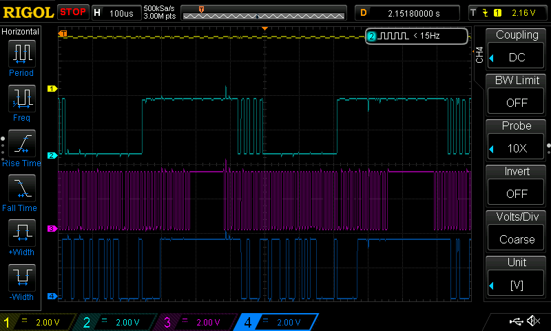

    Signals are all there: yellow reset line, light blue: TDI; dark blue: TDO; purple: TCK.
    I mean in the datasheett is written:
    On the 2803x device, the JTAG port is reduced to 5 pins (TRST, TCK, TDI, TMS, TDO). TCK, TDI, TMS). So it should work with these 5 pins, right ?
    I see signals ongoing on each line.

  • Ok, now I looked at the XRS pin, it is low, but I have 2.2k Resistor pull-up on this pin. As far I understood this pin should be high... Will investigate now this issue...

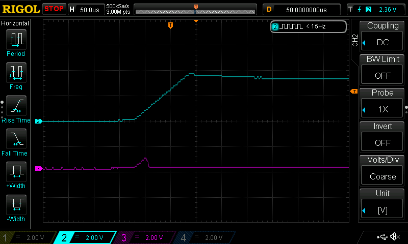

    so, I did some further investigations. Here is a screenshot from my 3.3 volt supply (blue) and the XRS Pin (purple) on start-up with a pull-up 2.2 kOhms between XRS and 3.3V:
    Do you think any problem in power supply?

  • Ferdinand,
    Can you also check the 1.8V supply?  XRSn will not be released until both 3.3V and 1.8V supplies reach a minimum threshold.
    -Tommy
  • Hi Tommy,
    that was the right tip. We connected VDDIO with VDD, so VDD pins were also supplied with 3.3V. I did not see, that the VDD pins should not be connected to the VDDIO 3.3V since it is running with 1.8V.
    Processor survived and I can program it now.
    Problem solved.
