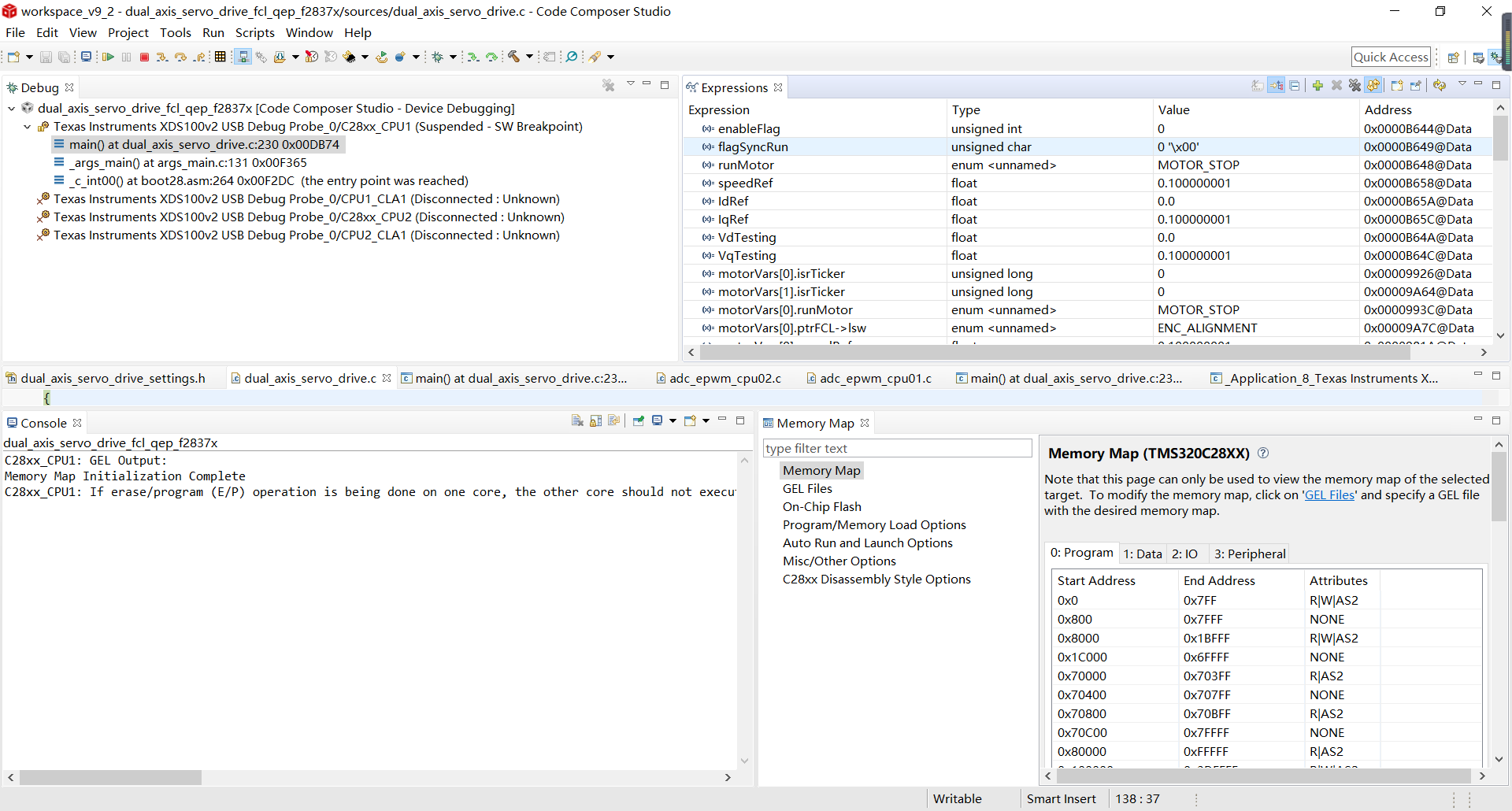

I use 28379d and 3phganinv to test the dual motor routine (Level 1),all the steps are in accordance with the document: "dual axis motor control using FCL and SFRA on a single C2000  MCU” 。
I did not remove the R20, but according to Yanming Luo, the removal of R20 does not affect the test (Level 1).
The program only uses CPU1, I can't display the waveform in real time.
 I make sure that all my operations are carried out according to the file.
How to solve this problem? I hope you can help me,thank you very much indeed.
Here is a screenshot of me burning the dual motor routine:
1.main interface:

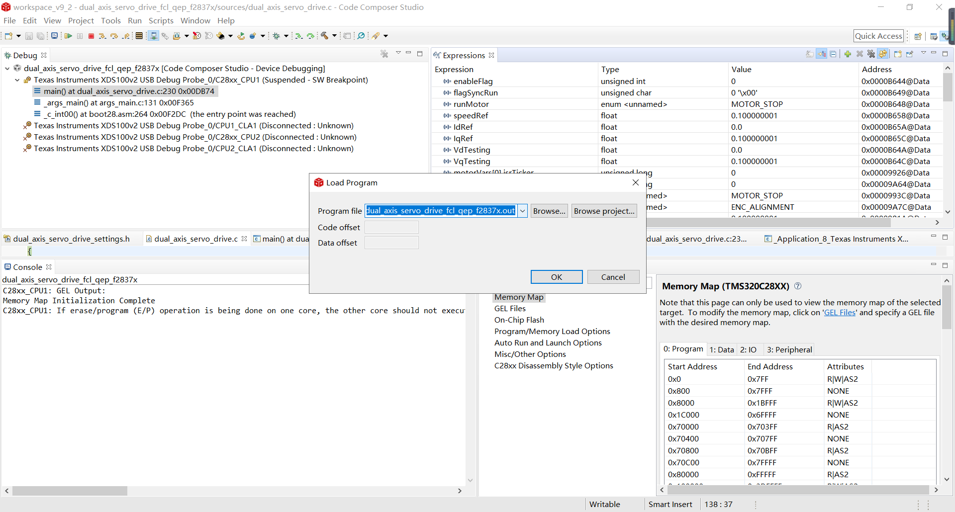

2、Click "debug"

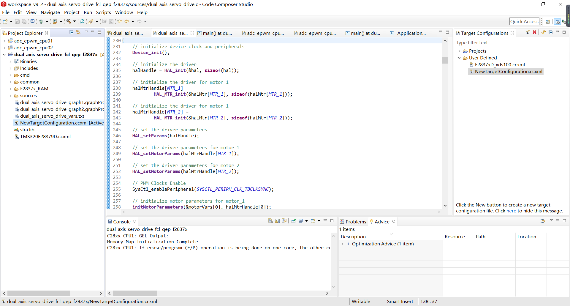

3、add. Out file to CPU 1 ,import the variables
4、“Enable silicon real-time mode”  andselect "YES"(maybe ignore this step)

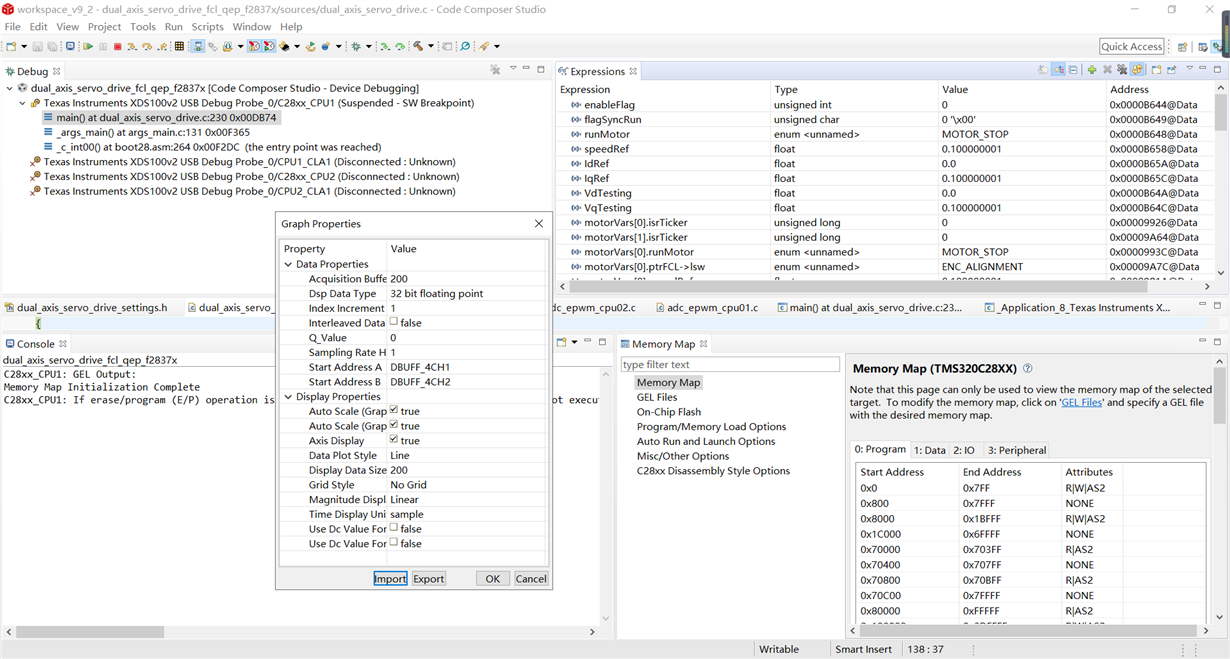

5、Setting up Graphs

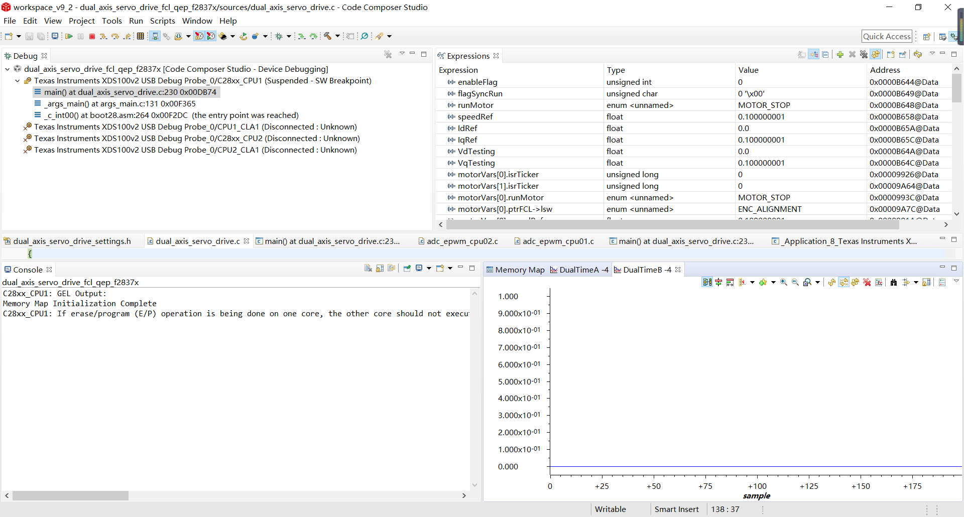

6、Run the code,set the variable ‘enableFlag’ to 1 (There's a problem. There's no waveform)
  • 1. Recommend to remove the R20 on both 3phganinv boards since the on-chip DACs are used in all build levels. The over-current fault may be trigged for the current offset is not correct if the on-chip DAC is enabled.
    It seems like the "tripFlagDMC" is "1" in the watch window that means there is a fault to stop the motor. Set "clearTripFlagDMC" to "1" to clear the fault, and then set the "runMotor" to "MOTOR_RUN" to see if the outputs are correct and the "tripFlagDMC" is "0".
    2. Ignore the step “Enable silicon real-time mode”.
    3. Click the "Continous Refresh" button in the Graph window.
