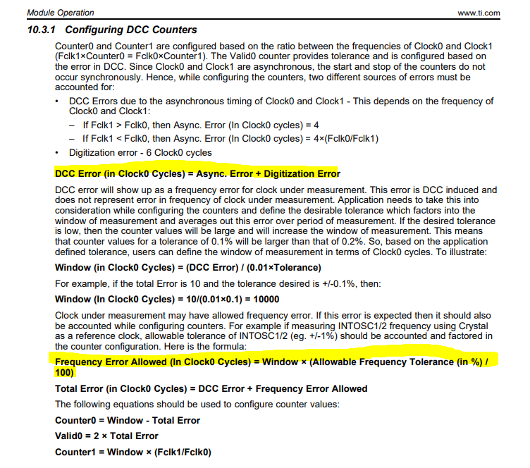

2. Using DCC - code is from C2000Ware examples (compare input to output clock frequency ratio.)

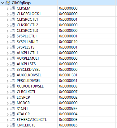

  • Hi Milosz,
    Thanks for your quick response, can you also dump clk_cfg_regs (mainly clksrcctl1 and PLLSYSCLKDIV) for any of the above failing configurations?
    Nirav
  • Nirav,
    all ClkCfgRegs (at the moment of leaving IsPLLValid function) are listed below. Please note that PLLSYSCLKDIV settings is applied after PLL clk is validated.
    Milosz

    Thanks, their are 2 possibilities based on the data you provided:
    1. XTAL frequency is drifting over time, and hence when you set the tolerance to high value like 2.5% you see a pass, but with a lower tolerance value like 1% you see it a fail.
    2. Async error in DCC is higher than 10 (probably 18) and hence you are seeing a fail. This seems unlikely, because based on your first message, you are seeing similar % error when you are capturing ePWM output, but still cannot rule it out.

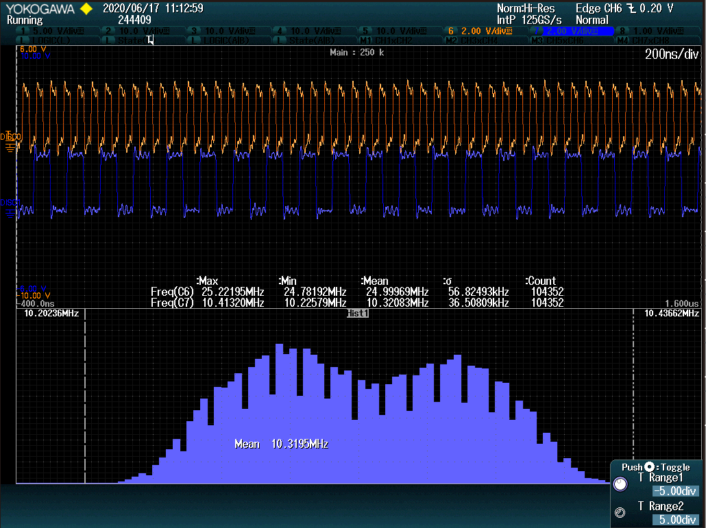

  • Nirav,
    If I understood correctly, DCC measurement is immune to clock source frequency drift - it measure only ratio between two clock signals.
    Ad.1
    I measured input clock signal and PLLCLK/8 (CLKSRC3 = 0, XCLKOUTDIV = 3)  over period of several hours, so statistical information is rather good. Please find results below:
    Orange (C6) - input clock (measured on TP6)
    Blue (C7) - PLLCLK/8
    I did measure also XTAL on XCLKOUT (CLKSRC3=7, div=0) and results are nearly identical to those presented on first chart.

  • Hi Milosz,
    Thanks for the data, this is really useful in debugging the issue.
    Few questions on the plots:
    1. What is the sample size and time span of both the histograms (XTAL freq. and PLL freq)?
    2. PLL frequency histogram (in blue) markers shows different values of frequency than the one's shown in the bottom stats (that has min, max, stdev etc.)?
    3. What is the time scale of histogram (time per divison)?
    4. Are you using XTAL in a single ended mode ore connecting to X1 and X2?
    Few observations from your data (based on my interpretation of the scale)
    1. XTAL frequency histogram (orange) seems to span from -400ns to 1.6us, which is 2us. And in this period of 2 us XTAL frequency drifts from 24.78MHz-25.2MHz, which is about ~420KHz (1.7% total error).
    2. PLL frequency histogram (blue) has spikes at regular intervals, which suggests that input XTAL frequency drift happens in a step. And as you might know PLL is feedback loop which locks the i/p phase to the o/p phase of the PLL, hence it is trying to re-lock to changing input XTAL frequency.
    3. If you look at the DCC counter ratio which is Counter1/(Counter0+valid0) = (0xFFFFF-0xFBEA9)/(0x3DC+0x18) = 16.5, which is off by 0.5 (as the configured ratio is 16). This suggests 2 things, either DCC synchronization error is really high almost 2% that is making the ratio 16.5 or PLL is drifting to different frequency and overclocking DCC counters (which is likely the scenario now that we looked at the frequency plots which shows spikes).
    4. Window of DCC Counter measurements is Counter0+Valid0=1012 Clock0 counts = 40.48us (considering 25MHz/40ns input period), can you plot frequency histogram of both XTAL and PLL frequency for time span of 50us? Also, from your earlier data when you were setting Tolerance value to high number you were seeing a pass, but when you moved it to lower value you got a failure. This observation is supported by the plots you sent, where when the window of DCC measurement is small (With higher tolerance) it shows a pass.

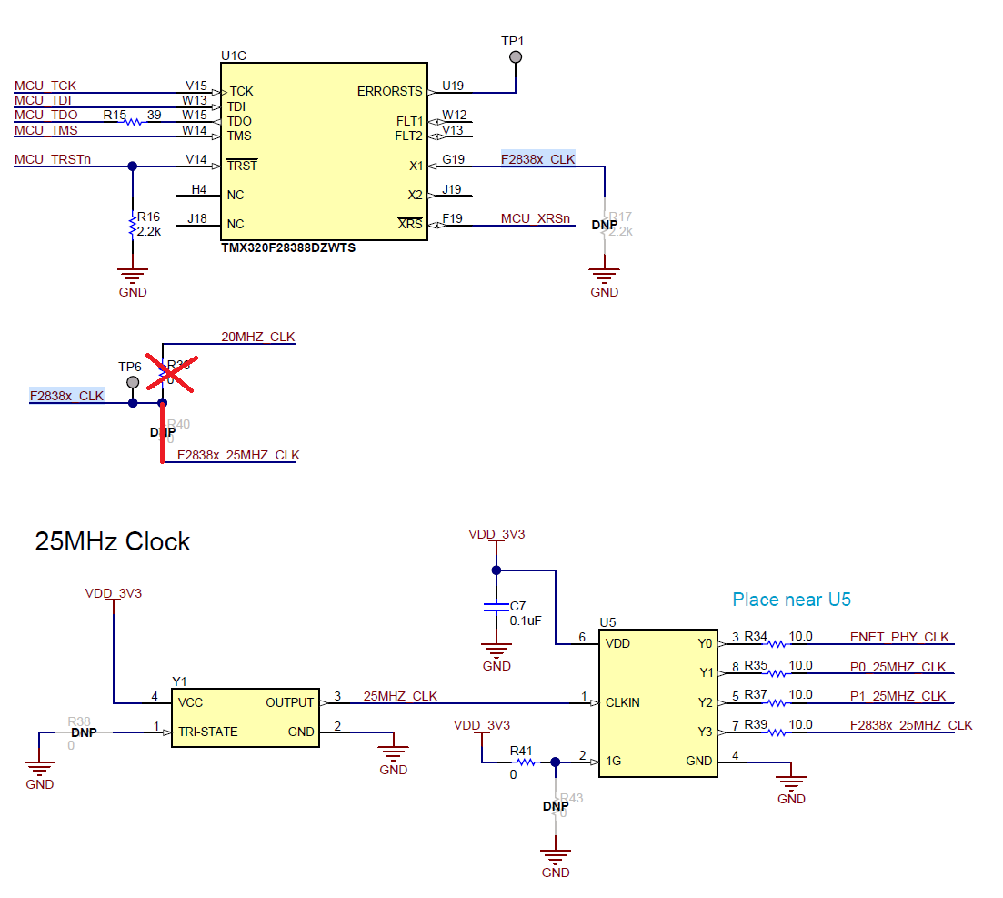

    Overall I feel the XTAL frequency is not clean and has high ppm value, hence PLL is drifting and causing a failure. You can account for XTAL frequency accuracy/error of 2% in the DCC calculation as shown below. Image below is from the latest TRM release, C2000Ware will be updated in the next release.

  • Nirav,
    Histograms generated by this oscilloscope are only to visualize distribution and they do not provide any detailed information.
    Ad.1:
    I do not have exact numbers. Oscilloscope has collected ~27000 samples over several hours.
    Ad.2:
    Blue is Channel 7 (C7), Orange is C6. I did not notice that in both pictures there is stat data for Channel 6 and looks like all screenshots I took has the same issue. The only information from PLL histogram that remains in pictures is the histogram boundary: f_min=25.7, f_max=26,2 and f_mean ~= 25.7MHz. The most important is that center frequency of PLL is higher by ~0.7MHz on PLL (blue) and it is much wider (see histogram min/max cursors on both C6 and C7)
    Ad.3:
    XTAL (C6) frequency span: ~0.5MHz
    PLL (C7) frequency span: ~1.8MHz
    Ad.4:
    Single ended. Eval board only modification was different clock source (see picture):
    My comments to your comments :)
    -400ns to 1600ns is TIME DOMAIN span - it has no application to frequency histograms. It is asymmetric because trigger point is set to 20% of screen (see T marker on top).
    1 sample on histogram represent 1 frequency measurement (which is taken over 2us time window). In total there are ~27k samples on histogram.
    I do not have a possibility to measure clock stability over short period of time (50us) that I would trust.
    I can provide another measurement results with INTOSC as clock source tomorrow.
    Milosz
