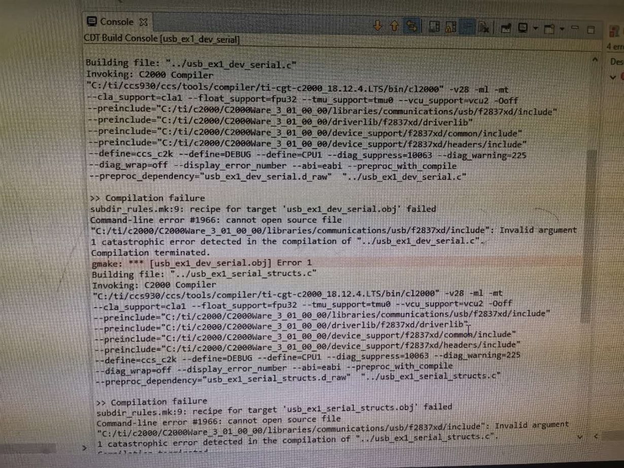

i want to test usb function and download the example code from CCS under (C:\ti\c2000\C2000Ware_3_01_00_00\driverlib\f2837xd\examples\cpu1\usb\).
the CCS version is 9.3.0 and C2000ware version is 3-01-00-00 .
the error is shown in below:
pls advise.
Feng
  • Feng,
    Looks like it is unable to find the  include folder:
    C:\ti\C2000\C2000Ware_3_01_00_00\libraries\communications\usb\f2837xd\include
    Can you check if you have this folder on your setup?

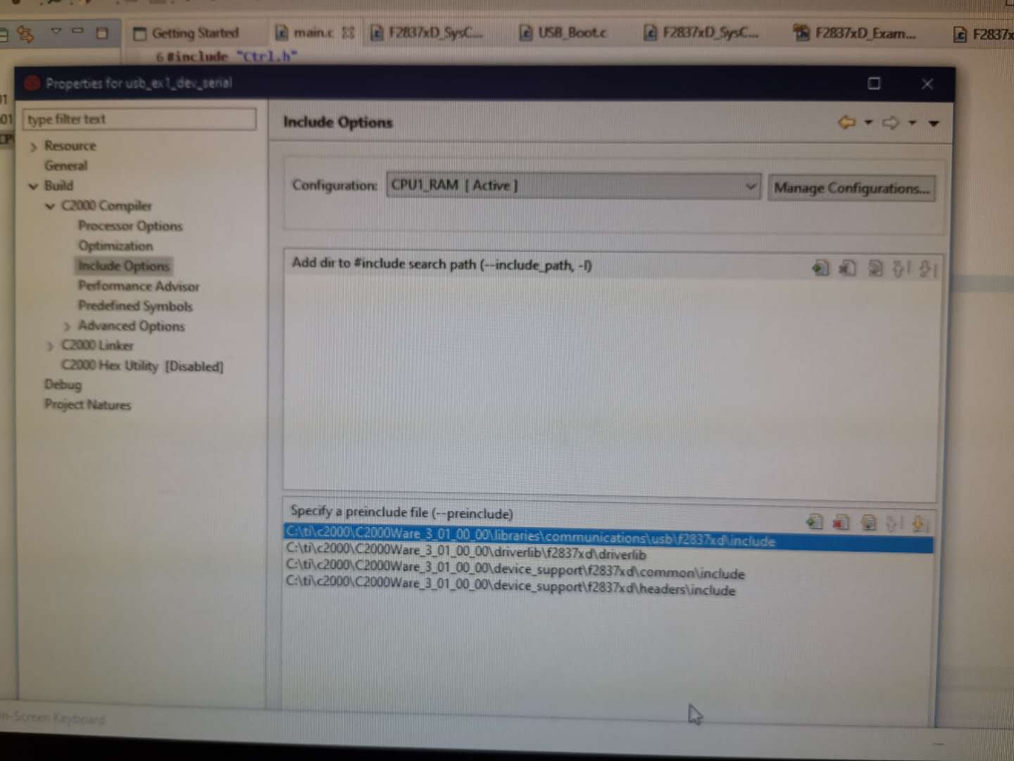

  • Hi Santosh,
    i include that in my setting, pls refer to below:
    Let me explain more about the case, it runs okay for old version of using ControlSuite. it is very clear that what header file and what source file i need include. but  now, it is upgraded to use C2000. the example of usb library is under C:\ti\c2000\C2000Ware_3_01_00_00\driverlib\f2837xd\examples\cpu1\usb. the error mentioned above is triggered when compile. actually i am not sure what header file and what source file i need include and there is no any instruction about this. please help.
    Right now i can not use usb library after upgraded to C2000.
    Feng
  • Feng,
    First of all, can you check if you have that include folder on your computer. The error sounds like the folder does not exist.
    Can you just import same example from C2000ware and compile?
  • Hi Santosh,
    checked that the included folder is in my computer. pls refer to below:
    yes, other example code, such as sci_flash kernel or usb flash kernels under c:c2000\C2000Ware_3_01_00_00_device_support\f2837xd\examples_dual\  can be exported and works fine. only example under libraries\communications\usb can not be compiled.
    Feng

  • Feng,
    Looks like you did not import the project properly. Lot of settings are not correct. The include option page should look something like below
    Please import the project in fresh workspace, and then compile.  The screen should look something like above.
