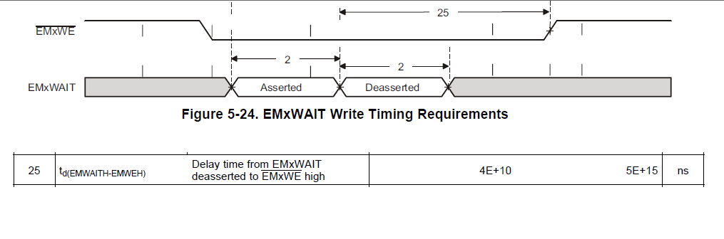

    4)
    So here it is the common case where EMxWAIT signal is de-asserted before timeout defined at 1) ?
    Alexandre.

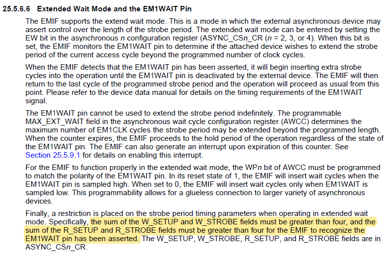

    Note that there is a requirement for SETUP+STROBE > 4:
    And the EMxWAIT has minimum Duration and Setup time requirements:
    I would recommend thinking of it in terms of the EMIF state machine looking for the EMxWAIT signal on the last cycle of the programmed STROBE period.

    if the strobe phase is equal to 15 ns and the EMIF detects EMxWAIT asserted after 5 ns, it will add extra strobe cycles until EMxWAIT is sampled de-asserted by the EMIF.
    But then the EMIF will finish the 10 ns of the strobe phase before to enter into the HOLD phase ? or this time will be shorted ?
    The STROBE period will be the greater of either the programmed STROBE or the Extended WAIT STROBE.
    I don't understand this question. Are you asking about this timing diagram?

    tlee said:
    DA_AGL
    4)
    Yes it is exactly this, timings 11 and 25.
    I suppose that these times define the case where EMxWAIT is de-asserted before the EMIF timeout as described in timings 10 and 24.
    Alexandre.
  • Correct, 11 and 25 describe the behavior for when EMxWAIT is de-asserted before the WAIT timeout is reached.
