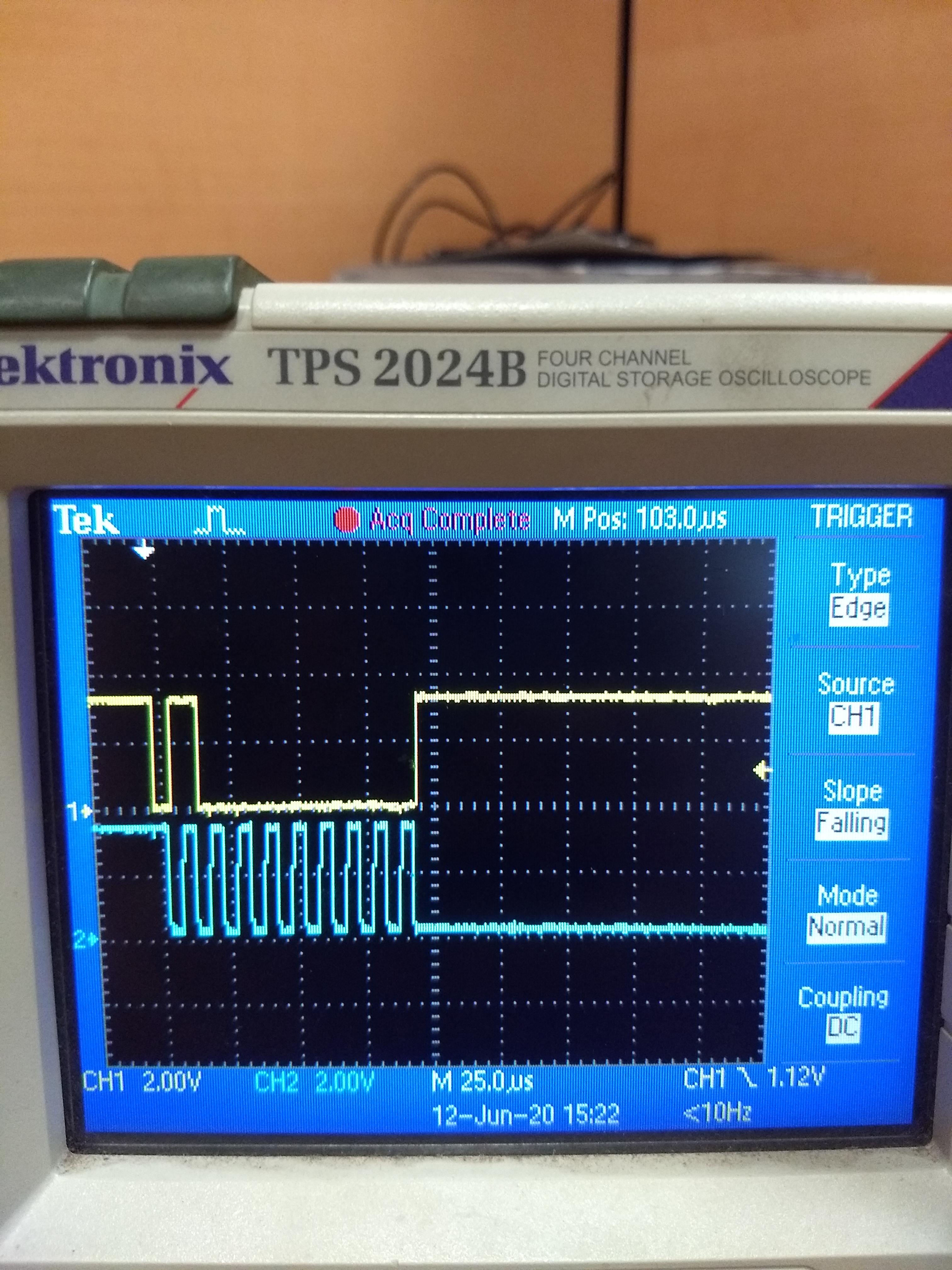

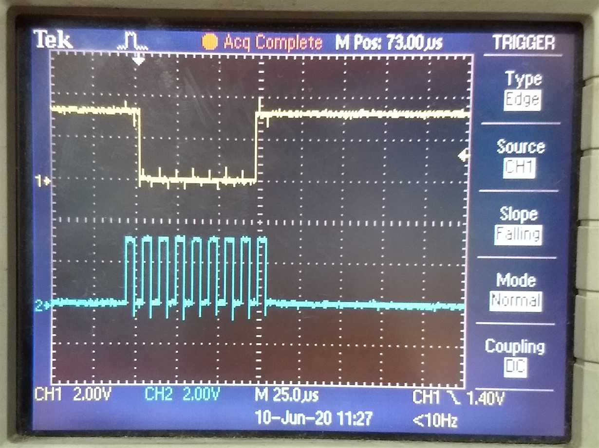

The following are the scope shots I obtained while executing the above code
The above scope shot is obtained when I executed step (1) in the code. Slave address with write bit 0x80 and is acknowledged by the slave successfully.
The above scope shot is obtained when I executed step (2) in the code. Slave address with write bit 0x80  for initiating a RESET  command to first slave. But at this point I am not receiving an acknowledgement but the same slave acknowledged to START signal in the previous step. After this step (2) I am not obtaining any response on the scope. Why this is happening?

  • You don't need to delay before setting the STP bit. You can set it immediately. The hardware won't actually send it until the data count counts down from I2CCNT to 0. Also, it looks like at some point in your code you change the number of bytes you're sending without updating I2CCNT.
    Can you try putting some while loops in your code to make sure you aren't moving on to the next transmission before the I2C flags say it's ready? This is a better approach than using delays and it will give us some more information about what is going wrong. For example, after you send the STP bit, wait until it is clear before moving on, or before you start a new transmission, check that the BB bit isn't set, etc...
    Please use the C2000Ware examples for reference and check out the tips on I2C here:
    http://processors.wiki.ti.com/index.php/I2C_Tips
    Whitney

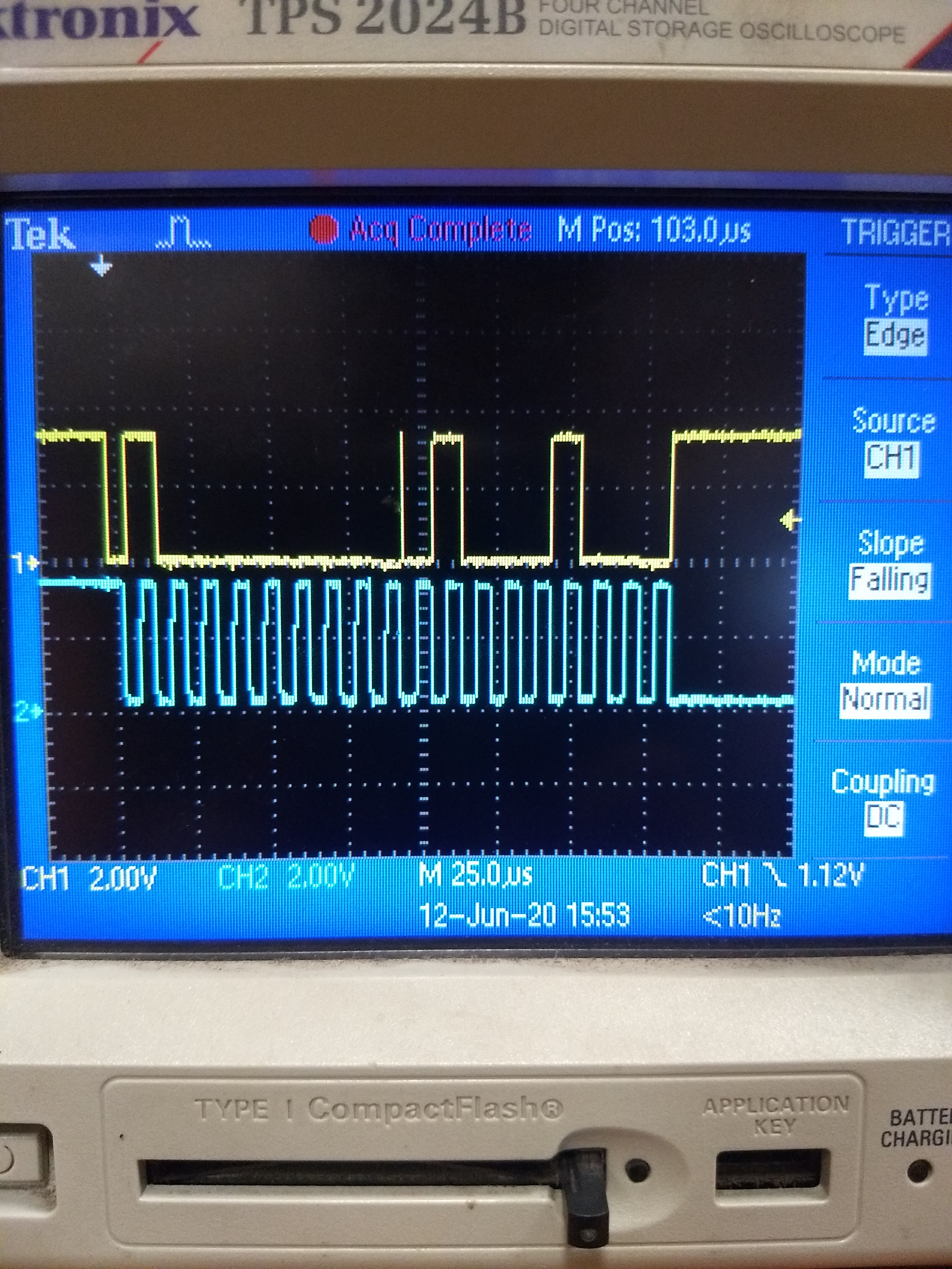

    Now I can acknowledge one byte transfer but not more. That is in first section of the code I have given data count 1 and wrote one data to I2CDXR then sent a START signal ( (1) in the code). The following is the scope result.
    And when I increase my data count to 2 and I am not using FIFO mode. I send START signal then first command 0x44 and second command 0x02 ( (2) and (3) in the code) after waiting for XRDY. The results I obtained are as follows.
    As we can see here the DATA 0X44 is clocked out successfully but it is not acknowledged by the slave why this happens?.
    After this I am receiving no response for command 0X02 and no STOP signal is generated. My data count is still 2.
    I observed another fashion in output when I moved the START condition just below command 0x44 that is
    I2caRegs.I2CDXR.bit.DATA            = 0x44; // WREG command and Configuration register 1 address(3)
    I2caRegs.I2CMDR.bit.STT             = 1; // Generate start signal (2)
    I got these shots on scope
    it is found that 0x44 is acknowledged. If write code like this
            I2caRegs.I2CDXR.bit.DATA            = 0x02; // CR 1 data
    only 0x02 is transferd and since the 0x44 is overwritten I think.
    For configuration and reading back the same I need to send commands and START conditions back to back. How it is made possible. If you can give a simple bit field example it will be of great help. I have little knowledge in coding and I already gone through EEPROM example ( which I understood only a little ) and datasheet structures for commands.
    Is there is any importance in position of START condition? I have seen some examples where START and STOP is already set while configuring I2CMDR.
    Which all registers should be addressed while keeping i2c in reset mode (IRS = 0),  Since TRM specifies only IPSC register?
    Thank You,
    Vineeth
  • When you poll on I2CMDR.STP, you actually want to wait while it's equal to 1 as that means that the stop condition hasn't actually been sent yet. The hardware cleans STP after the stop has been sent or in the case of a NACK.
    Is there any particular reason why you aren't using the FIFO? You may want to consider enabling it so you can send those data bytes back-to-back without one overwriting the other.
    I don't think it matters much whether you send the STT before or after writing to the DXR register. Either way it won't send the data until the STT bit is set.
