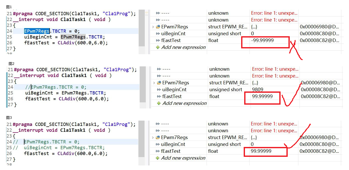

CCS/TMS320F28035: _CLAdiv() get wrong output with TI v6.4.2 version compiler in CCS6
Part Number: TMS320F28035
Hi
I am meeting an issue that as below show, CLAdiv can't get the right output, and get right output after adding one statement before the CLAdiv.
Below link is the software code, pls help analyze what is the root cause for this issue.
Thanks.

  • Hardy,
    For above issue, a bug was found during 2017 CLA performance improvement work.
           sir.ext.ti.com/.../EXT_EP-8463
    Above bug was fixed in:
         15.12.7.LTS, 16.9.6.LTS, and 17.9.0.STS (and all future releases)
    For below CLAdiv() example, the result of CLAdiv call is -99.999 instead of 99.999

    The bug is due to missing an extra instruction (or MNOP) below:
    00009000 _Cla1Task1:
    00009010 0000 MMOVIZ MR0, #0x0
    00009011 7840
    00009012 6984 MMOV16 0x6984, MR0
    00009013 75c0
    00009014 0000 MNOP
    00009015 7fa0
    00009016 0000 MNOP ---- need 1 more MNOP between above store to memory and below read from same memory
    00009017 7fa0
    00009018 6984 MMOVZ16 MR0, 0x6984
    00009019 7580
    0000901a 8c80 MMOV16 0x8c80, MR0
    0000901b 75c0
    For customers using older 6.4.x release, one way to look for the bug would be to build their cla files with 15.12.6.LTS (which has the bug) and then also build with 15.12.7.LTS (which fixes bug).
    Then compare the assembly for both. Only need to look at differences around memory stores followed by load from same memory location.  Then add enough __mnop() intrinsics to ensure there are at least 3 instructions between write and read from same memory location.
