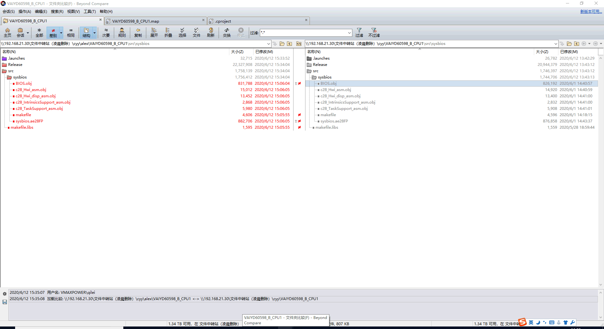

My customer is designing F28388D with SYSBIOS. When they moved CCS project to different PC, .hex output file will be different and 10K different in code size. We compared .project file for all the build options and linked resources, just file things related to TIRTOS are different. As shown below:
Could you give us a list to check these things in detail?
