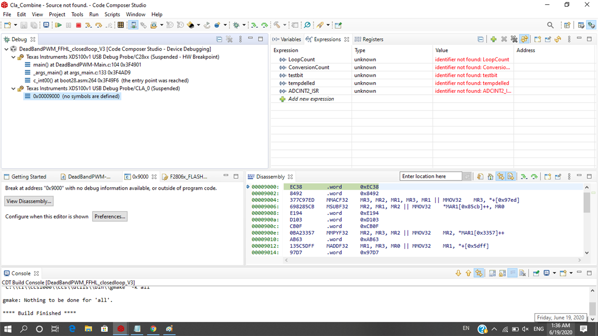

TMS320F28069: Error While Build Project Operation
Part Number: TMS320F28069
Hi, I am trying to configure CLA on TMS320F28069.
But,When I Perform Build Operation, It Shows Error of which i Have Shared Screenshot.
Please Help me to understand and rectify it.
Thank you

    Basically, whenever I build Program it gives me error,
    " [E0002] CLA instruction requires valid CLA.asm"
    And, In F2806X_CLA. asm all the Assembly Instructions are Highlighted by "x" sign in left side in red color.
    Thank you

    Hey,One Update , I rectified that Error now,
    When I Run Project I have Assigned one Testbit Variable in (_CLAISR2),  So that Whenever CLA2 Task Completes "TestBit "is Incremented by one.
    But ,Testbit is not Changing.
    Thank you.

  • Did you set the break-point in ISR?  ISR does not work?
    I didn't set the break-point in ISR.
    But, I have one Doubt that should I select "CLA0"   OR "CLA1" in specify cla support.
    Thank you

    It is Showing "Break at address "0x9000" with no debug information available, or outside of program code." error when i try to debug CLA.
    I have Uploaded Image of same.
    Thank you
  • Mihir,
    I am assuming that you are able to compile it successfully now, is that correct?
    For CLA, you will need to load symbol  CCS menu Run -> Load -> Load Symbol and point to the same out file.
    If you want to stop, then you will need to add following statement in CLA task function.
    __mdebugstop();
    I will try that.And what about That Error of which i have sent Screenshoot.
    And could you please sent me Linker command file which i can use for CLA and c28 combined project.
    which is suitable for Experimenter kit TMS320F28069.
    Thank you
