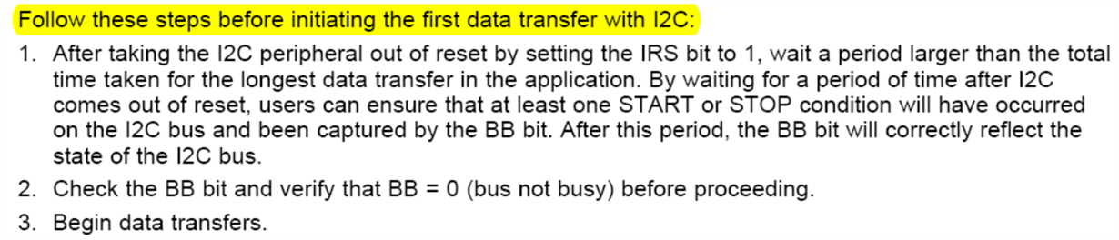

While going through i2c section in TRM I came across this.
I didn`t really get it.
1.What is meant by wait for a period longer than longest data transfer ? how do we find it, the longest data transfer?.
2. It is said that by waiting for such a long time we can capture a START or STOP and it will be captured by BB bit. My doubt is that even before we initiate a communication how can the device capture START or STOP signal ? Since communication itself start only after START signal which is set by the user
Thank you,
Vineeth

  • Vineeth,
    After C2000 I2C comes out of reset, BB bit may not correctly reflect I2C bus state. It requires either START (or) STOP condition after reset for BB bit to correctly reflect the state of bus.So, after taking I2C out of reset wait for time period equivalent to time taken for 16 (FIFO max length) bytes of I2C data are transferred before checking busy bit (BB).
    This information  should have been worded better. I will file a ticket and fix this in next release of TRM.
    Manoj

  • Vineeth,
    After you bring I2C out of reset by setting IRS bit, you need to wait for atleast 1.3ms (in case of 100KHz standard mode) (or) 320 us (in case of 400 KHz fast mode). After this time period, BB bit will correctly reflect the status of bus. If I were you instead of wasting my CPU cycles on wait time, I would be performing other tasks during that wait time. Other than the wait time and not checking busy bit, I don't see anything wrong in your code assuming you have taken care of configuring I2C properly.
    Manoj
  • Hi Manoj,
    Thank you for your replay. Now I have a clear understanding of the statement.
    For others if who are reading this thread, in the previous post I have calculated data transfer time wrongly. I have calculated it based on input sampling rate i.e. 20SPS. The data is actually clocked out based on i2c master clock which is 100 kHz in my case. So, for 16 byte transmission the time required will be  16*8*10 micro seconds = 1.28 milliseconds. Like wise you can calculate for other modes also which is mentioned by Manoj here.
    Thank you for your support Manoj.
