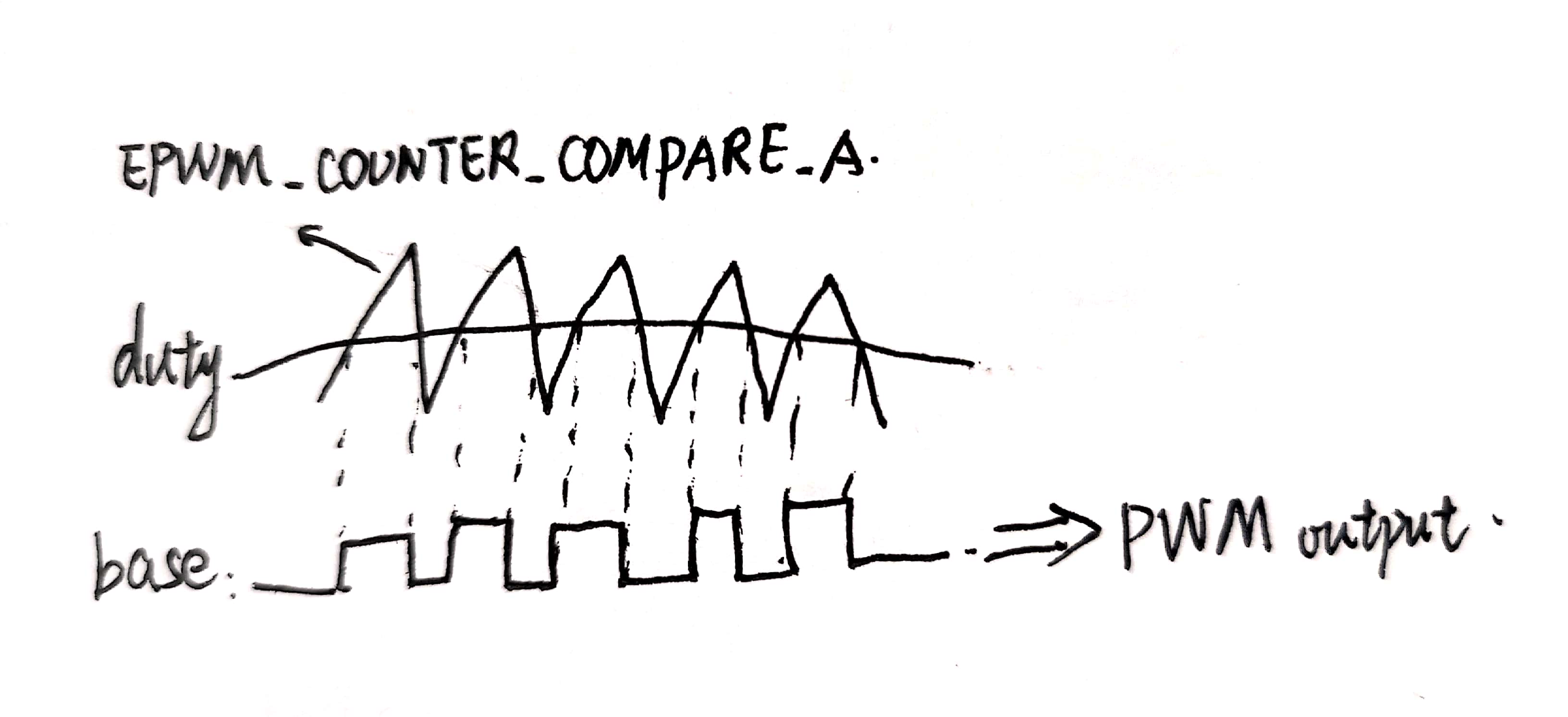

  • Another question:
    How to deal with the duty cycle of dut1ypu input during the current loop debugging? Put duty1pu and PWM_ Period multiplication is assigned to duty1, which is used as modulation wave and triangular wave epwm_ COUNTER_ COMPARE_ A compare the output PWM?
    Which base1, what is this? Modulation wave? Or the last PWM output?
    The corresponding procedures are as follows

  • You could search for VIENNA_HAL_updatePFCviennaPWM
    Base 1 in the function:    #define VIENNA_HIGH_FREQ_PWM1_BASE                 EPWM1_BASE
    I think your understanding is correct.

    For Vienna_ HAL_ EPWM_ Setcountercomparevalueoptimized function. Is the function executed as shown in the figure below?
    The update PWM program is as above. Is my understanding right?
    I think the waveform looks fine but your note is not accurate. For more detailed information, please check figure 4 in the user guide. You could also check PWM module in TRM to understand how counter and comparator work.
