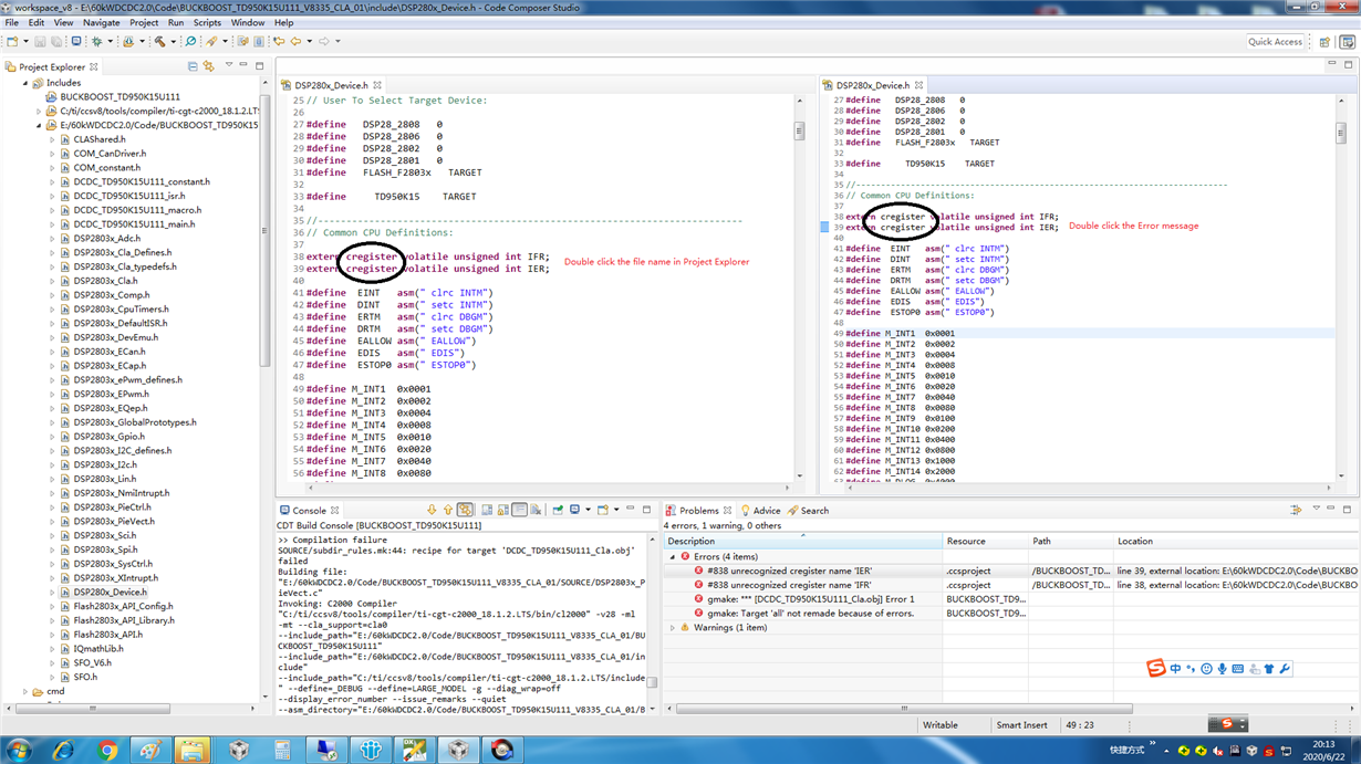

When build my project, #838 error, console display as below
I check E2E , have the same question :
e2e.ti.com/.../559968 unrecognized cregister name 'IER'
 Add #include "F2803x_Cla_typedefs.h" in the first included header in  DSP280x_Device.h , it does not work ,  still  unrecognized cregister name 'IER' and  'IFR'
 Check the picture above I think the compiler don't unrecognized keyword "cregister " but in F2803x_Cla_typedefs.h
#ifndef __TMS320C28XX__
#define __cregister
#endif //__TMS320C28xx__
The above picture i double click the error message  to open DSP280x_Device.h ,and the display show "cregister "is not a keyword and unrecognized .
But when i double click the file name in Project Explorer, the display show cregister  is a key word , display show as below
Then I edit one DSP280x_Device.h, the other one change simultaneously, so i think this two windows of DSP280x_Device.h display the same file, but in the different display?
Need suggestion the correct the build error, thanks
    It sounds like they are the same file.  In the project Explorer you can right click on a file name, select properties, under Resource you can view the location of the file.   Does this match up with the error information?

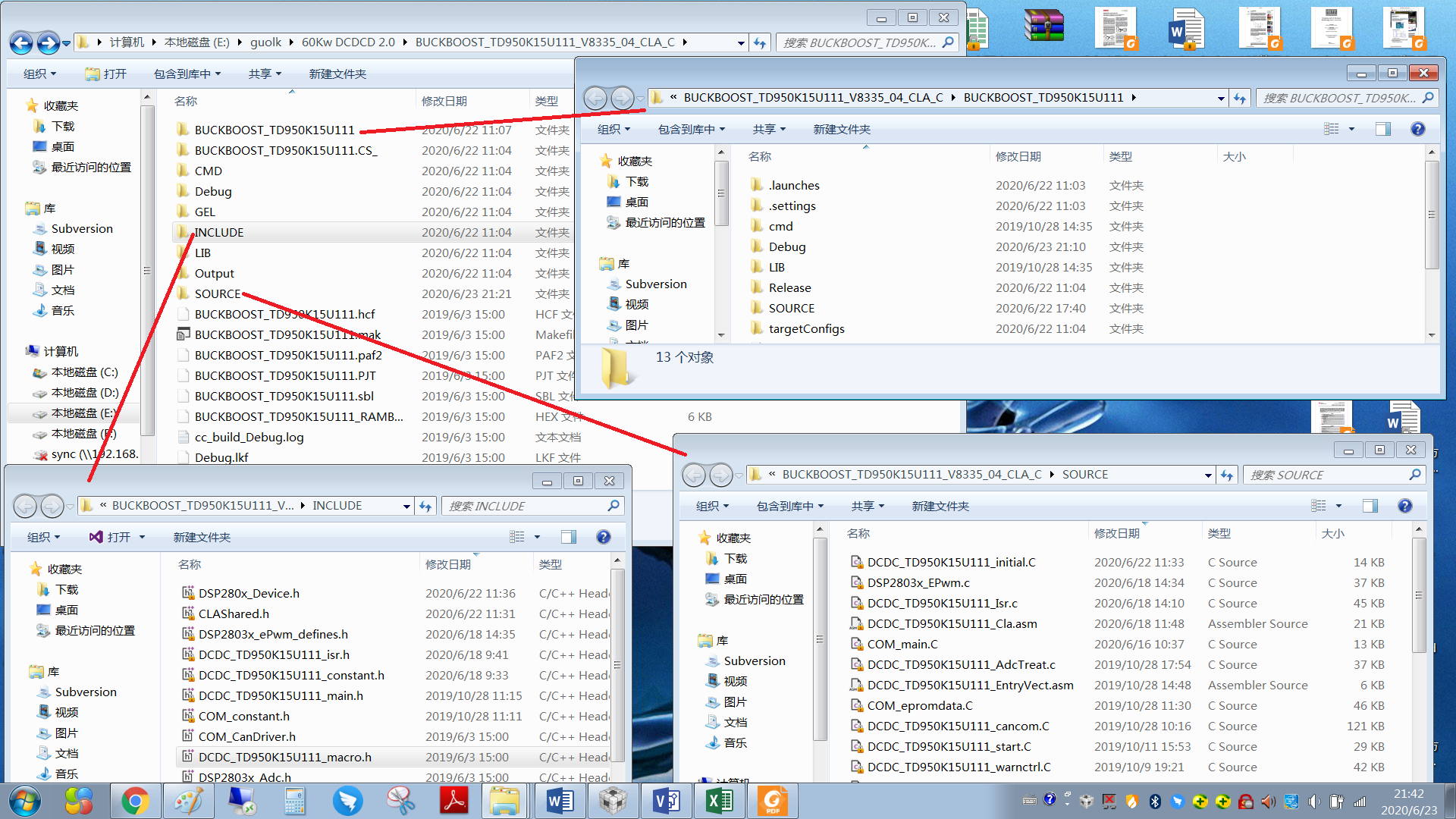

    I right click on project name , the properties shows as below:
    The project file :
    This project was  organize for CCS3.3 or CCS7.4/8.1 in one project file.
    The CLA  code was write by assembly in the old project,  l plan rewrite the CLA code use C
    After I add the cla file and change the related content of CMD file,  rebulid the project, #838 error,.
    Need more suggestions, Thanks.

    In my project, I change the order of include files, error #838. Then I do the test on CLA example(C2000ware\device_support\f2803x\examples\cla\acos),test result same as yours. Then I check the file content of DSP28x_Project.h
    The original #include "DSP2803x_Cla_typedefs.h "is before #include "DSP2803x_Device.h" compilation success. Then I change the sequence of this two code, compilation error, #838 console :
     I check the code in "DSP2803x_Cla_typedefs.h,  I think have nothing with unrecognized cregister name 'IER'&'IFR', just as  Vishal_Coelho mentioned   make sure DSP2803x_Cla_typedefs.h is the first included header in that file, why?
    e2e.ti.com/.../970962
    Then I modify Device.h as your suggestion, compilation success. But, according the console information before code modify, how can i know the definitions be used  in a .cla file result in compilation #838error, thanks for your support.
