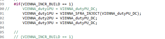

In open loop program,VIENNA_duty1PU=VIENNA_SFRA_INJECT(VIENNA_dutyPU_DC),Why not just make VIENNA_duty1PU = VIENNA_dutyPU_DC?
That is because we add/enable the SFRA in the code in default. You could also use the code you mentioned. As you could see, it is commented out.
For more information on SFRA, please refer to
