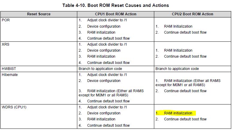

The following table shows that when WDRS (CPU1) occurs, CPU2 performs a RAM initialization.
Does this RAM initialization initialize 0xD00 of CPU2 to 0xFF? Or does CPU2 not initialize 0xD00 and maintain 0x5A?
