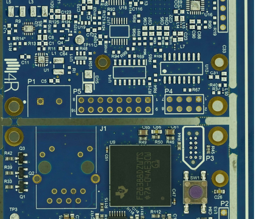

Good morning TI.
I would like to know if the F28388D is capable of reaching SIL-4 level.
If not, why and what deviced do you have that support this level?
If yes, how could we endorse it to our clients?
Thank you

    We have developed a small radar device for traffic and railway control systems. The SIL-4 requirement is for the radar's train detection.

    Thanks for your question about the capability of F28388D reaching (or being endorsed) for SIL-4. Let me provide you with as complete an answer as possible. Please let me know if you have any other questions.
    1. IEC 61508 (which is the parent of the railway safety standard such as EN 50128 or 50129 that you might be referring to) requires that HFT be >/= 0 for SIL-4
    2. If you are using a single F28388D MCU on your system your HFT (at least from the MCU perspective) = 0
    3. Consequently, you are not meeting the normative architectural requirement for a SIL 4 system as required by IEC 61508
    Hopefully this helps answer your question...?

  • Hi PAk:
    Here are answers to your questions:
    Question: How could we demonstrate that F28388D reaches SIL-3?
    Answer: F28388D is not targeted to meet the SFF required to meet SIL-3
    Question: for example its PFH and PFD?
    Answer: </=100 FIT
    Question: Would we need a RTOS for certification of the software?
    Answer: Requiring an RTOS, the type of RTOS used are all system level choices that have to be finalize by the system integrator.
