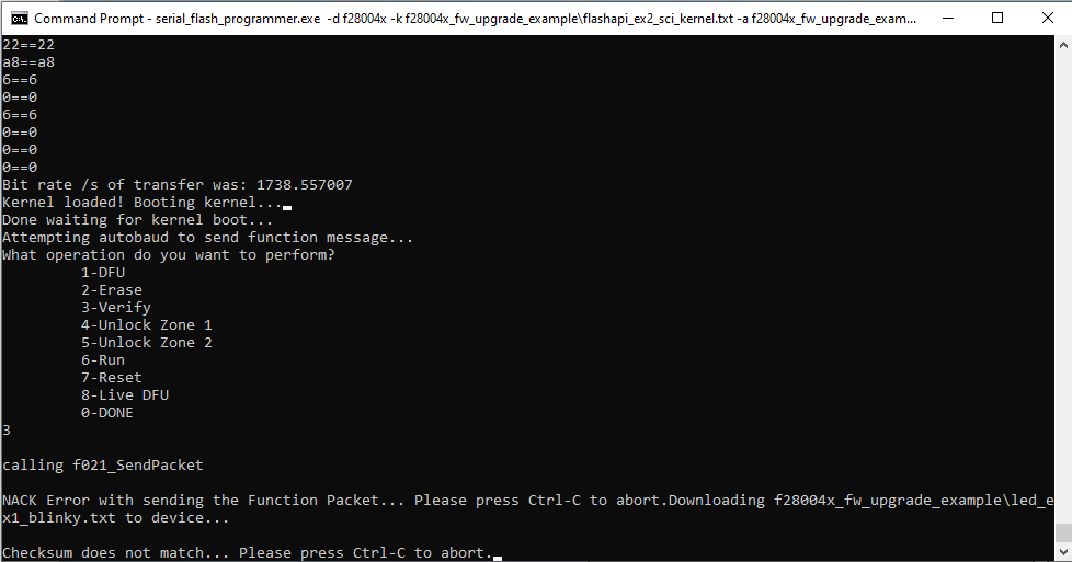

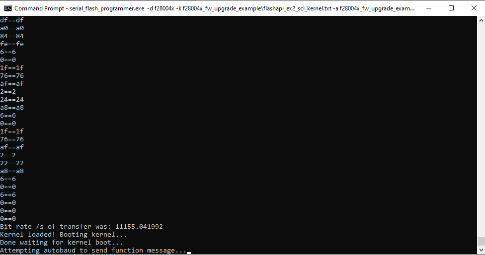

I recently set up an experiment with a Serial to USB cable to try and talk to a LAUNCHXL-F280049C. I did the basic serial_flash_programmer f28004x_fw_upgrade_example with led blinky, and got it to work on the launchpad. I am trying to use the same cable and same program on a custom board to test the device's serial communication abilities. I use the command "serial_flash_programmer.exe -d f28004x -k f28004x_fw_upgrade_example\flashapi_ex2_sci_kernel.txt -a f28004x_fw_upgrade_example\led_ex1_blinky.txt -p COM6 -v" to run the .exe, and it begins the data transfer. I used the same command with the launchpad. Afterwards, it states the bit rate, states that the kernel is loaded, boots the kernel, and then attempts "autobaud to send function message," where it seemingly freezes.
I thought I was correctly booting the board in SCI mode with the GPIO 24 pin low and GPIO 32 pin high, and I'm connecting the RX and TX pins to the GPIO 28 and 29 pins. I believe the pins are hooked up correctly because the data transfer is working up until this point. I am very new to serial communication, so I apologize in advance if I ask very basic questions regarding this issue.

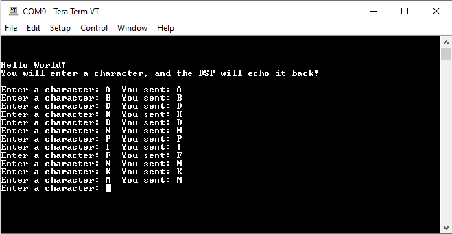

  • There is no FTDI chip, GPIO 28 and 29 go straight to the header pin, about 1 inch away from the MCU. The CSM is unlocked, we are just trying to prove the SCI bootloader. There is a clean, un-programmed device. To verify the SCI functionality, we ran the SCI echoback example, and it functioned correctly.

    Good to know that you're using an unprogrammed device, and that the SCI loopback example (baud rate = 9600) works.

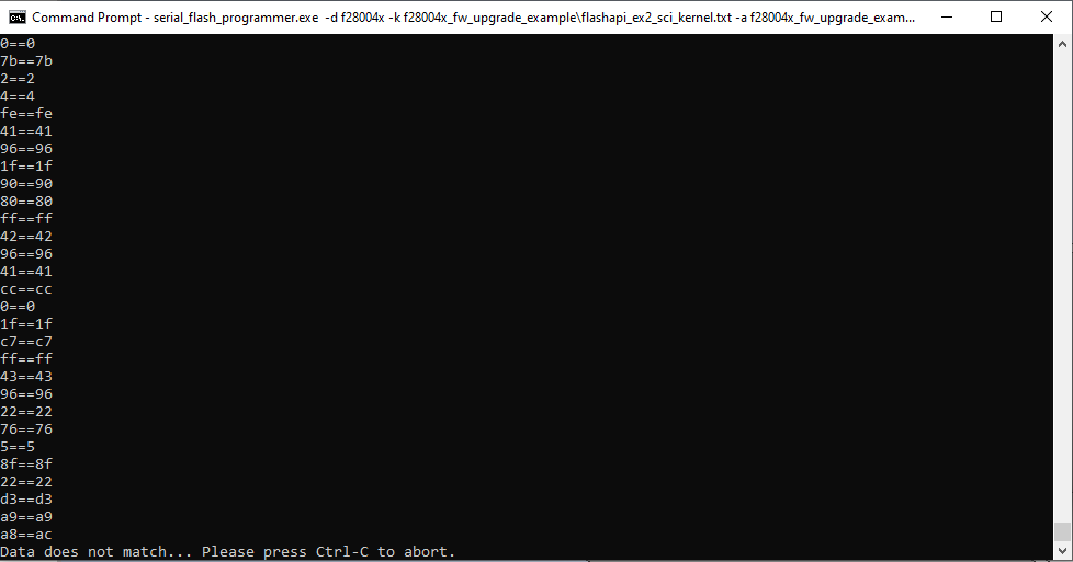

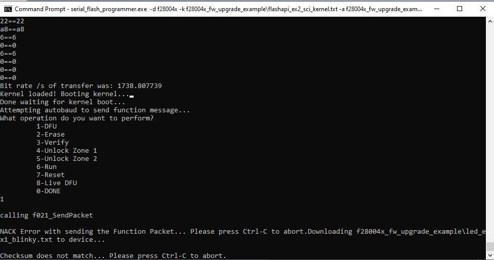

  • I am using C2000Ware 2_00_00_03. When I use a lower baud rate (4800) I will sometimes get a "data does not match" error. It will happen in a different place everytime.
    If I don't get this error, the kernel boots, and the "attempting autobaud" succeeds! I get to choose which operation I would like, but when I do I get a "checksum does not match" error.
    What does the NACK error mean? How can I resolve the checksum error?
    Thanks for your time,
    Josh
  • The NACK error means that the checksum failed. When the Flash Kernel is being downloaded to RAM in the first step, the ACK-NACK handshaking happens at the byte level (which is why you see the sequence of prints like 6f == 6f). Once the kernel boots, and the app is being downloaded to Flash, the ACK-NACK is replaced by a checksum that is sent by the device to the host at a block-level to speed up programming.
    This checksum appears to be wrong, leading to the failure.

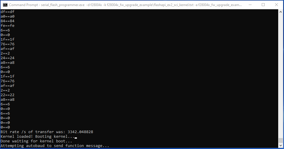

    Thanks for the explanation. I tried a higher baud rate (38400) and I got the same results. I downloaded the newest version of C2000Ware (3_02_00_00) and ran the same commands at differing baud rates. I still got some occasional data matching errors, but when I didn't I either had the same scenario where I got a NACK error or my original problem, where I get stuck at "attempting autobaud to send function message". I did multiple tests and got different errors with differing baud rates, and there didn't seem to be a pattern to when I would get certain errors.
