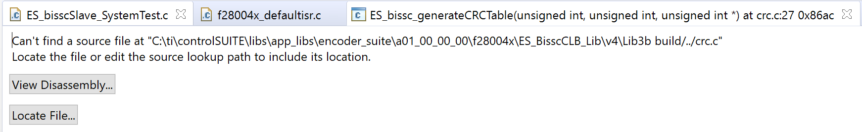

  • Hi Lori,
    The return of illegal ISR seems come to library and no source code. BTW, I didn;t have this directory on my hard disk.
    Sheldon

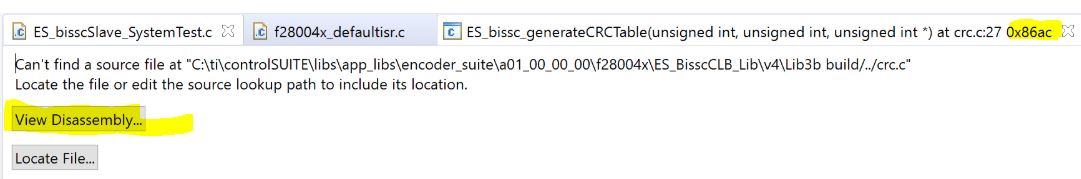

    If you open the disassembly window (view disassembly) you should see where the function is and if it looks corrupted.
    Are there any ITRAP instructions?

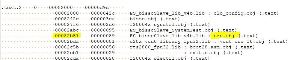

    The .map file shows the function is running from flash.  Could the code security module be blocking it from execution?
    The screenshot shows that the crc.c function is located in address 0x86... but the linker .map file shows it at 0x82...
  • Updated screenshot in previous post.

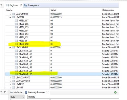

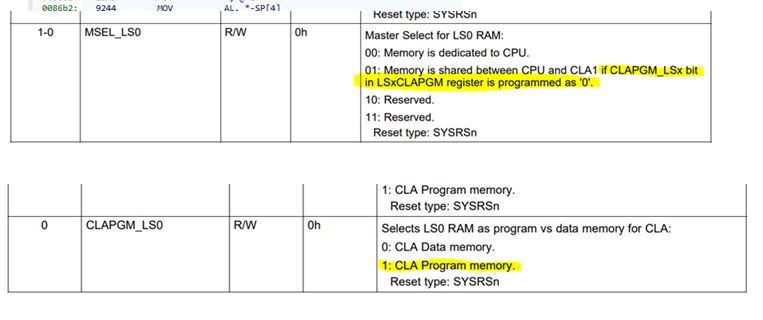

  • This was resolved offline.
    The SARAM block where the code ran was configured as shared between the C28x and the CLA and, at the same time, was configured as CLA program memory.  These are not compatible configurations.  SARAM on this device can be shared as data memory between C28x and CLA, but not as program memory.   This configuration caused the C28x to hit an ITRAP ISR when it attempted to execute code from the block.
