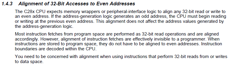

For debugging purposes, I will need a 32 bit unaligned atomic memory load/store access.
The following example will describe my issue:

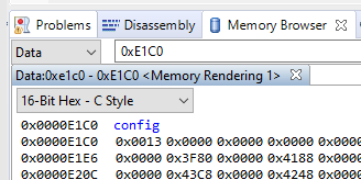

uint32_t ReadedValue =  *((uint32_t*)address);
If I read 32 bit at 0xE1C0 i will get 0x00000013 which is correct.
If I read 32 bit at 0xE1C1, i will read 0x000000013 which is not correct.
How can I read the right value of an unaligned address?
