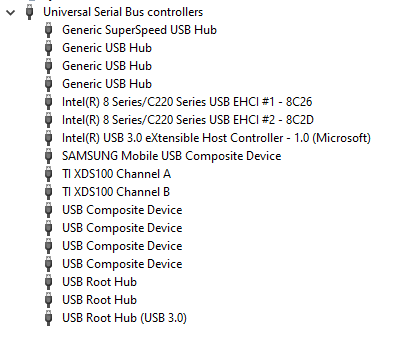

The usb com port is not identified on their computer. In PORTS(COM & LTP) its not detected they can see TI XDS100 Channel A TI XDS100 Channel B under Universal Seriel Bus Controller. And when trying to run and build using Embedded Coder, there is a error device not connected.

  • Hi Kevin, Based on their feedback, this is what they are seeing on their side. XDS100 Ch A and B.

    I'm not certain why they are seeing 'TI XDS100 Channel A/B' under the USB drop down. This is not something I have appear when I plug in my own LAUNCHXL-F280049C, maybe they have another board plugged in through USB (it looks like they have a number of USB devices plugged into their PC)? The F28004x LaunchPad does not have an XDS100 on the board, but a XDS110, which is what they should see under 'Ports (COM & LPT)' like I had shown.
    Can you provide a screenshot of what they see under the 'Ports' drop down?
