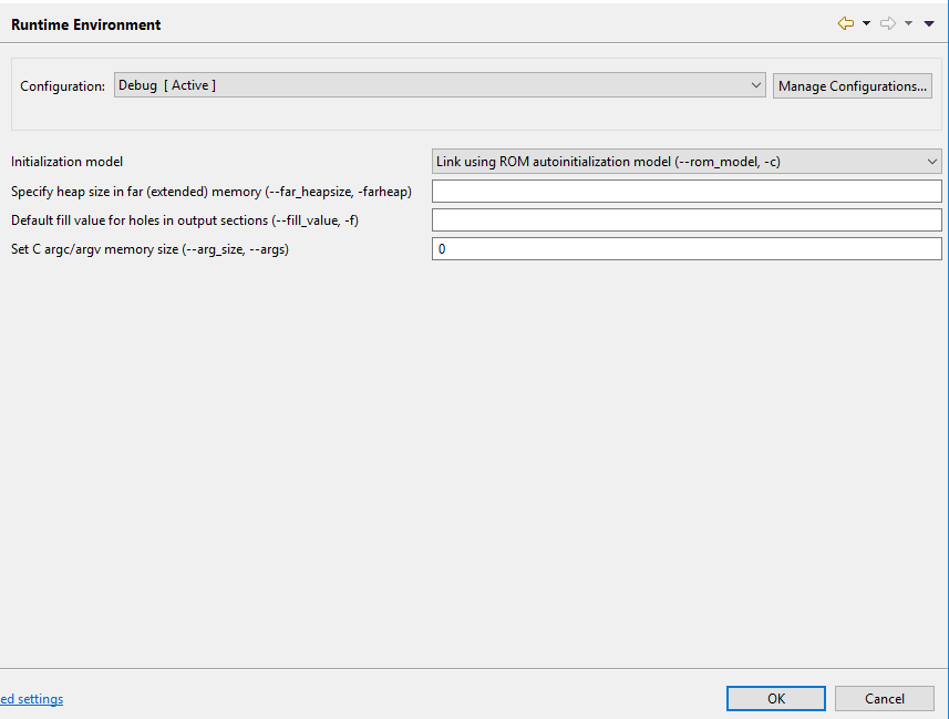

  • Stephen,
    Could you try passing the '--args=0' linker option explicitly on the command line for the .args section?
    Jas
  • Hello Jas,
    I tried to put --args=0 in the linker options and I think CCS replaces it with --arg_size=0 (see below).
    I deleted the build directory and rebuilt the project.  I can see the --arg_size=0 is in the console output when the compiler is linking.
    The args section is still in the map file:
    .args 0 0000db6a 00000004
    0000db6a 00000004 --HOLE-- [fill = 0]
    The project is using compiler version v6.2.11.  Rebuilding with compiler version v18.12.2LTS produced the errors shown below.
    Stephen
