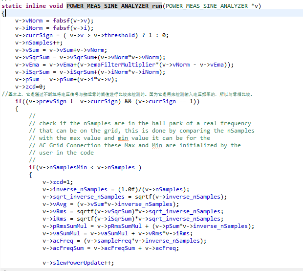

VIENNA_sine_mains1.i = VIENNA_iL1Meas_pu;
VIENNA_sine_mains1.v = VIENNA_v1Meas_pu;
POWER_MEAS_SINE_ANALYZER_run(&VIENNA_sine_mains1);
In this function,assign the instantaneous value of VIENNA_sine_mains1.v to v->vNorm,When calculating V->Rms, why multiply it by v->sqrt_inverse_nSamples?
