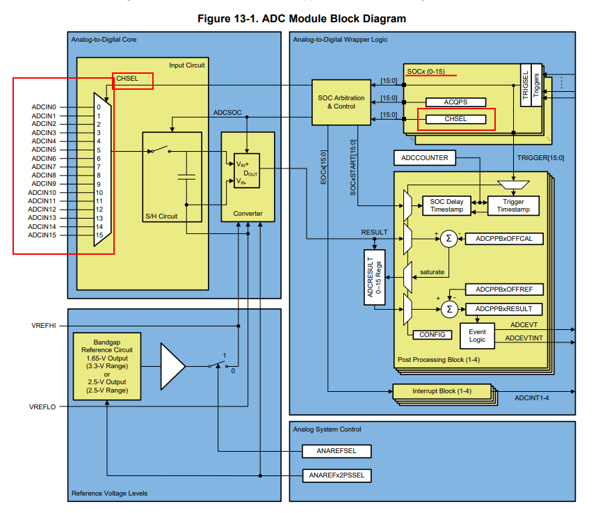

Greetings! I`m using this uC for a very first time and I not very familiar with its peripheral. So I`m watching the examples for adc. I can`t find the connection between the input pin(for example A0, A1, A2 and so on) and the ADC channels. Where do we specify this? How for example do I select the input pin for the ADC conversion to be A0 input? Is there any table? In which document?

  • Hi Pavlin,
    You'll want to start with the ADC chapter in the device TRM (https://www.ti.com/lit/ug/sprui33c/sprui33c.pdf?ts=1593693124759).
    The CHSEL field in the SOC logic controls the channel selection:
    And then note that results are stored by SOC number, not by channel number, so the results of SOC0 will be stored in ADCRESULT0 regardless of channel selection.
    e.g. ADCA->SOC0->CHSEL = 2 will store the results from sampling A2 in ADCA->ADCRESULT0
    e.g. ADCA->SOC1->CHSEL = 0 will store the results from sampling A0 in ADCA->ADCRESULT1

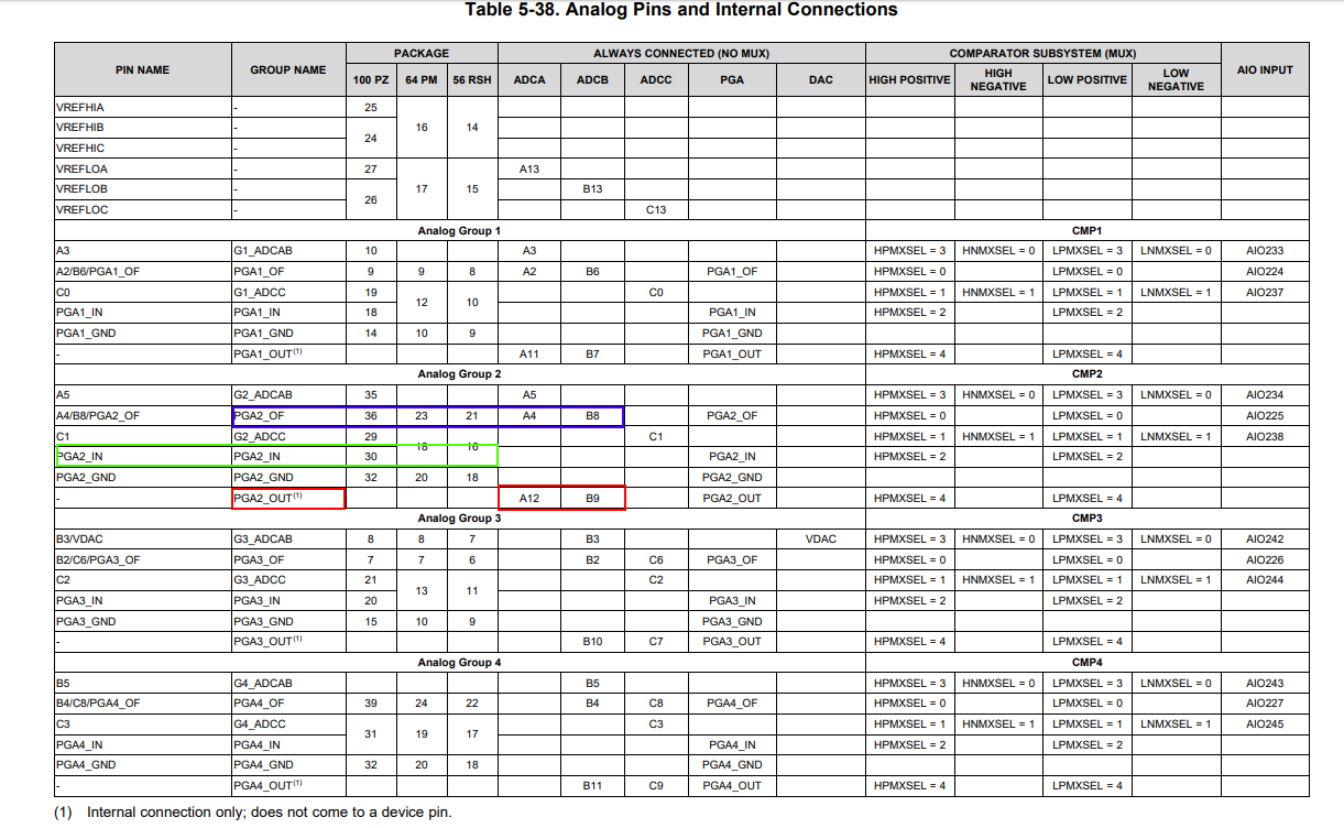

    But how to MUX the PGA inputs. I`m looking at the pga_ex1_dac_adc_ext_loopback example. There is selected PGA2_IN. The problem is in my case the row [code]
    pgaResult = ADC_readResult(ADCARESULT_BASE, ADC_SOC_NUMBER1);
    [/code]
    doesn`t work! I have a pinout to all PGA inputs but noone seem to work - follow the changes on the input. Rather that the analog input A10 is working correctly.
    I`ve tried with different selected channel -> ADC_CH_ADCIN11,ADC_CH_ADCIN5 and so on. No change.
    Do I have to select the PGA channel somewhere else? There is nothing in the example func initPGA connected to the MUX.
    Thanks!
  • Hi Pavlin,
    For each PGA, there will be 1 input pin (green).  You then need to enable the PGA output and read the PGA through the internal-only ADC input (red).  Alternately, you can route the PGA output to a pin so that you can add some capacitance for filtering purposes (blue).  This will result in needing to use a different input pin (blue).
