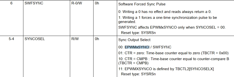

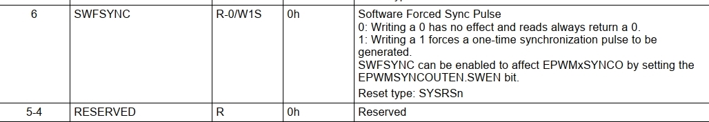

When we configure the ePWM signal of F280025, we find it lack the synchronization signal. How to synchronize those three ePWM signal? Do we need to synchronize those three signal? We find that in F280049, it has synchronization bit for ePWM. Could you check it for us? Thanks.
F280025 TBCTL Register 4~5 bit
F280049 TBCTL Register 4~5 bit
