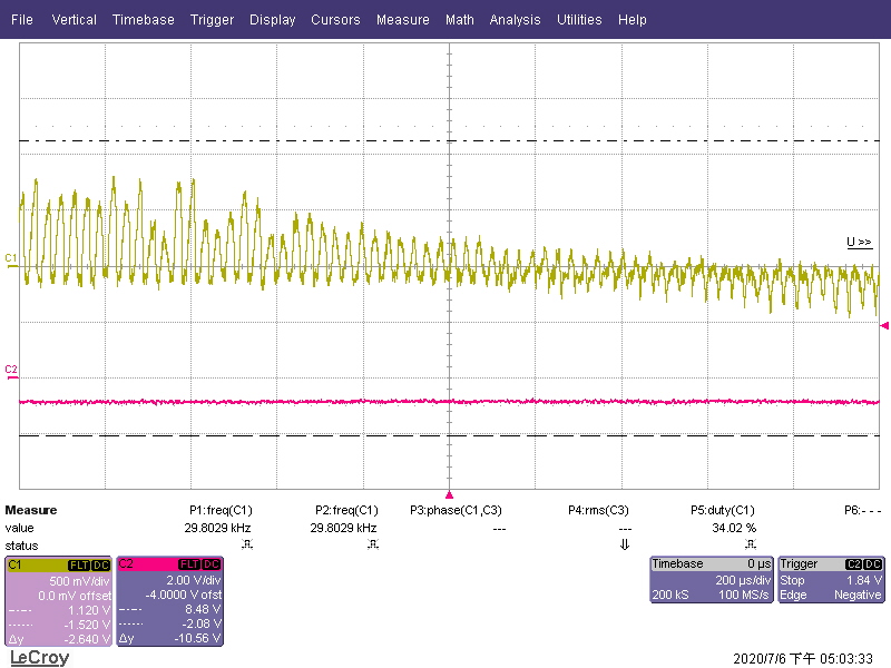

Here is my cricuit of BQ32002
A 32.768kHz osicllator(CM7V-T1A_12.5pF) whose capacitance is 12.5pF is connected between pin1 and pin2 of BQ32002. But it seems the  osicllator is not
oscillating perfectky. Below is the waveform between pin1 and pin2 of BQ3200. Any suggestions?

  • This oscillator has the correct capacitance, is it meeting the other specifications in datasheet table 6.3? Connection to the oscilloscope does appear to indicate that oscillations are occurring, thus it is unlikely there is some issue with the crystal oscillator.
    Probing a crystal oscillator may not always match your expectations due to several reasons. The capacitance of the scope probe will impact the oscillation. Too much probe capacitance will stop the oscillations. In this measurement, we can see the frequency is too low.
    Alternatively, you might use the OF bit (oscillator fail) to check for stopped oscillation. Remember to clear OF after power-up because it will initialize to true

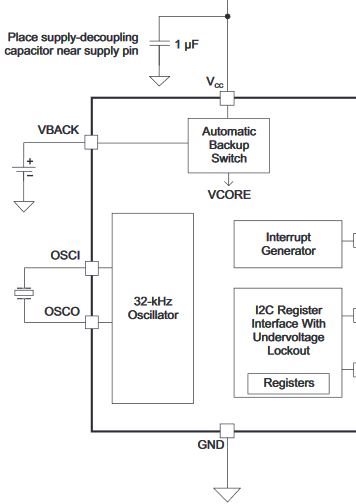

    May you show me the block diagram of the internal 32kHz Oscillator as shown below?

    I cannot share the block diagram. This an older device with limited design support.
