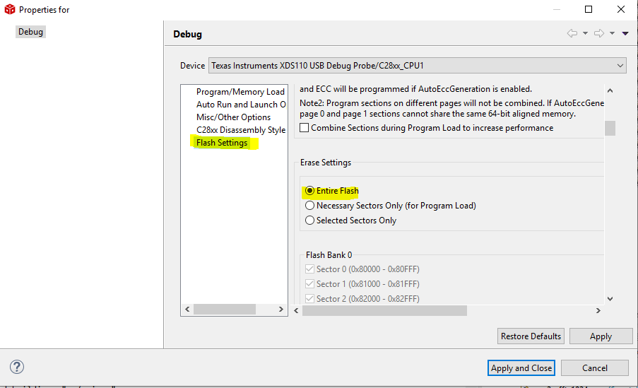

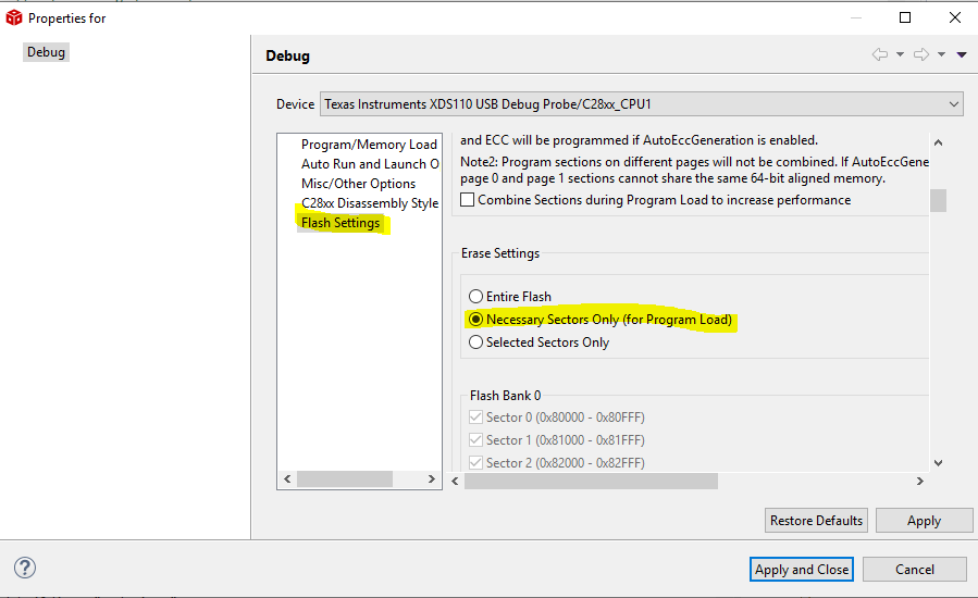

  • What hardware are you using? If you are using a F28004x Launchpad, it will have a Boot switch (SW1 on the Launchpad) that will control Boot modes. If you are using custom hardware, you will have to look at the boot mode table in the F28004x TRM, and set the associated GPIOs accordingly to achieve the Boot mode you desire.
    After programming the kernel on Bank 0, you should program the application on Bank 1. Then program the kernel on Bank 1, followed by the application on Bank 0. Then reset the board. The application should run on Bank 0 (most recently updated/programmed App).
    When you program the kernel on Bank 0 using CCS, it will not stop at main(), it will be waiting for autoBaud lock, so you can send the SCI command from your windows command prompt to download the application to Bank 1. Then reset the device. Then reconnect - program the kernel on Bank 1 using CCS. Now it WILL stop at main(), continue running, and then it will be waiting for autobaud lock, so again you can send the SCI command to download the application to Bank 0. Then reset the board.
    I would advise you to repeat the steps. Also, another piece of advice - when programming the kernel on Bank0, use a target configuration file that Erases all sectors of Flash. When programming the kernel on Bank 1, use a target configuration file that Erases only necessary sectors. Otherwise you will wipe out the previously written parts. See images .
