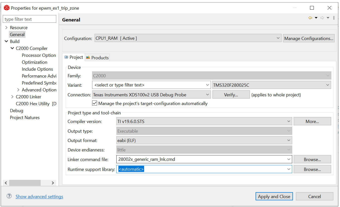

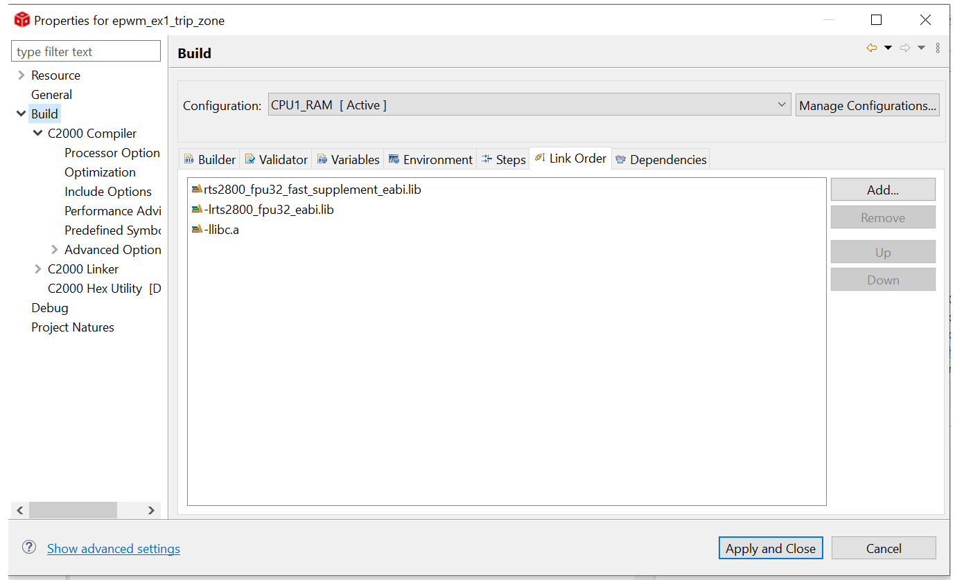

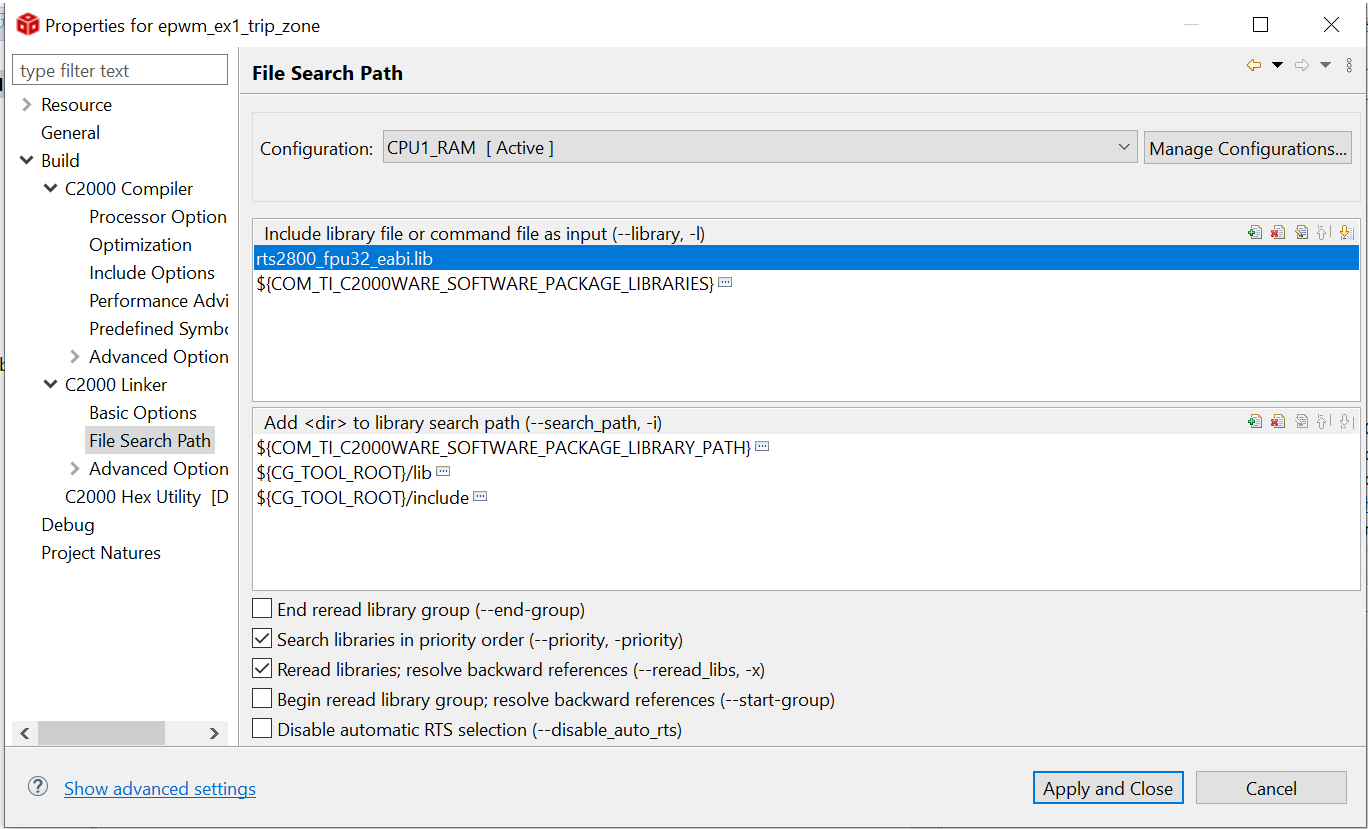

In "epwm_ex1_trip_zone" project in "C:\ti\c2000\C2000Ware_3_02_00_00\driverlib\f28002x\examples\epwm", below configuration has been set for using fastRTS:
