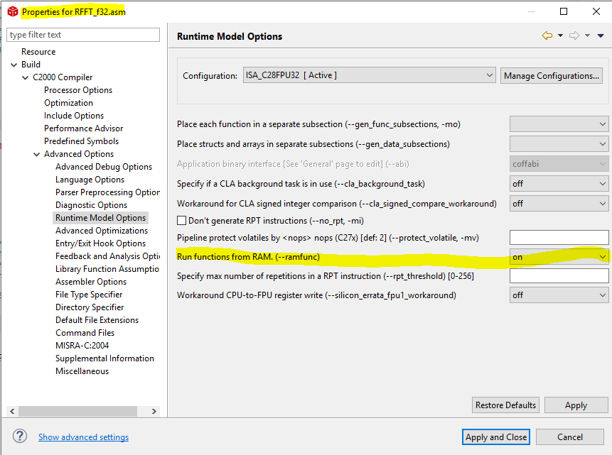

Is there a  RFFT sample code which load "RFFT_f32()"and"RFFT_f32_mag_TMU0()" from flash and run in RAM?
I run the samples of "C:\ti\c2000\C2000Ware_3_01_00_00\libraries\dsp\FPU\c28\examples\fft\2837x_rfft" and found it just copy _RFFT_f32_twiddleFactors to RAM only. while the RFFT_f32() running on flash.

  • Gavin,
    You could open the FPU DSP library project (c28x_fpu_dsp_library), change the project settings for the desired .asm file e.g RFFT_f32.asm as shown in the picture - right click on the file, ...then rebuild the library. Use this in your application project.
    Please try this and let me know if it works.
  • Hi Sira,
    thanks a lot for your quick response.
    I followed your steps and rebuilt the lib again. unfortunately, it seems still not copy function RFFT_f32() to RAM.
    Is there any risk if I use below statement out side the lib file?  thanks.
    #pragma CODE_SECTION(RFFT_f32,"ti.ramfuncs");
    #pragma CODE_SECTION(RFFT_f32_mag_TMU0,"ti.ramfuncs");
  • Gavin,
    I see. Please give it a try. I am curious what you find.
    #pragma CODE_SECTION(RFFT_f32,".TI.ramfunc");
    Sira
