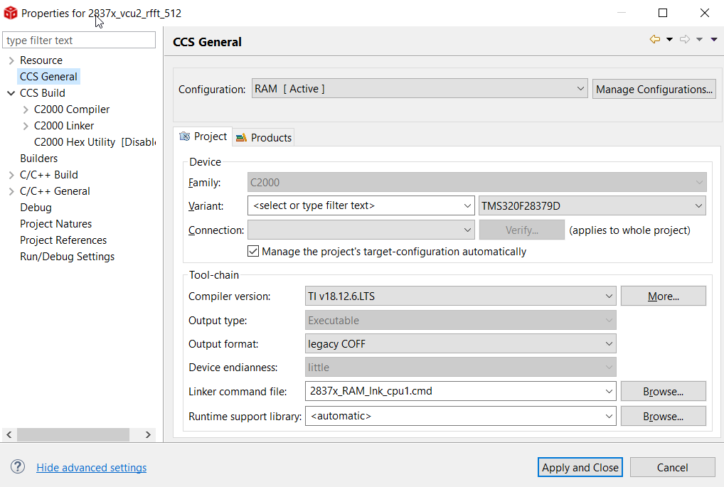

I have tried to compile the example 2837x_vcu2_rfft_512 from the C2000 ware, but I got an internal compiler error (see log.txt).
What is the reason for this error?

>> Compilation failure
subdir_rules.mk:72: recipe for target 'main.obj' failed
INTERNAL ERROR: C:\ti\ccs920\ccs\tools\compiler\ti-cgt-c2000_18.12.6.LTS\bin\ac2000.exe experienced a segmentation fault
                  while processing function (unknown or file scope) file (unknown) line 0
This is caused by a defect in the TI C/C++ Parser.
TI Customer Support may be able to suggest a workaround to avoid this.
Upgrading to the newest version of the compiler may fix this problem.
Contact TI in the E2E support forums at http://e2e.ti.com under
"Development Tools", "TI C/C++ Compiler".  See the link titled
"Submitting an issue".
We need to see this ENTIRE error message and a complete, reproducible
test case including ALL of the command-line options.
Include the .pp file created by option --preproc_with_comment
gmake: *** [main.obj] Error 1
gmake: Target 'all' not remade because of errors.
**** Build Finished ****
  • Ralf,
    Please upgrade to the latest C2000Ware version. In that, this example builds correctly with the Compiler 18.12.4.LTS. However, it throws an error with the latest compiler (v20.2.1.LTS), but this is something that should be identified and addressed before the next C2000Ware release.
    Sira
