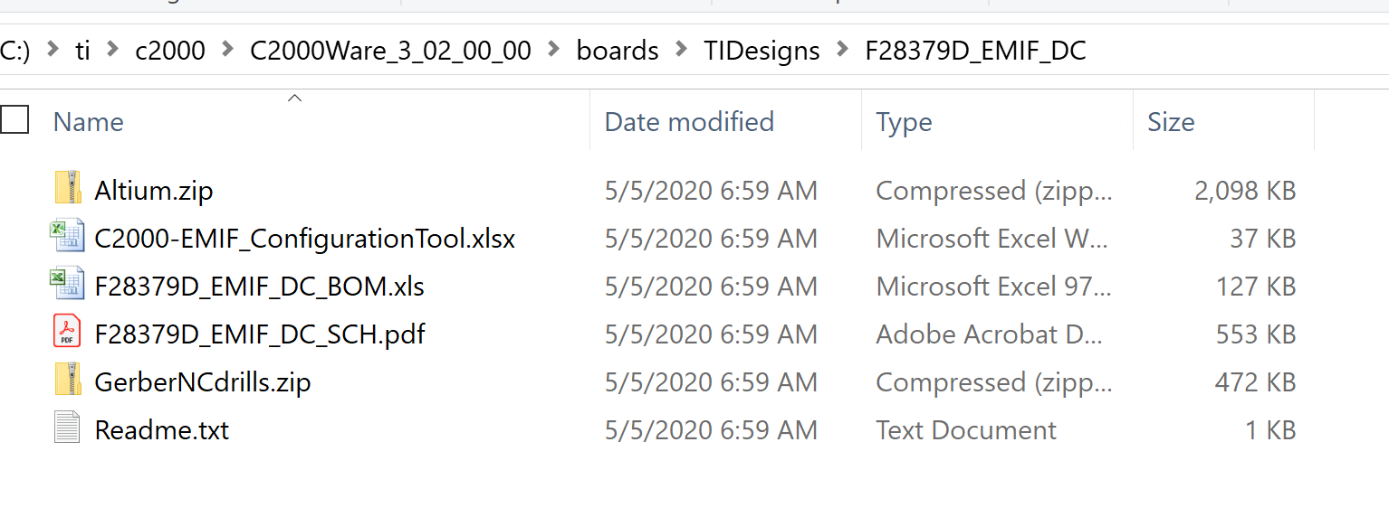

  • Hi David,
    I see all "EMIF_DC* files available in C2000Ware. Please see snapshot below (I see examples also).
    If you are not seeing it, please check if you have latest C2000Ware and make sure you are looking into right folder.

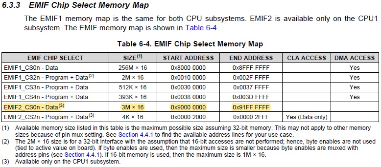

  • David,
    Your understanding is correct. The header is routed to EMIF2 on TMDSCNCD28379D, which has a smaller SDRAM address range than EMIF1 on LAUNCHXL-F28379D:
    -Tommy
