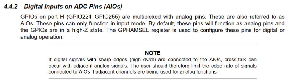

    AIO pins can be used a GPIO input only pins. Please check the description below. Regarding your concern about insufficient GPIO pins, we clearly specify the number of GPIO pins available in Table 3-1 Device Comparison table. I hope you had reviewed this table before you chose your device.
    Manoj

            1. I also see chapter 4.4.2, but only 21 pins which come from 224 to 246 could I find. So, where are the rest of GPIO/AIO?

  •         1. I also see chapter 4.4.2, but only 21 pins which come from 224 to 246 could I find. So, where are the rest of GPIO/AIO?
    Yes, you have only 21 AIO pins available to use. Table 3-1 Device comparison table also mentions only 21 AIO pins.
    AIO235, AIO243 is not pinned out and rest of the AIOs are reserved.

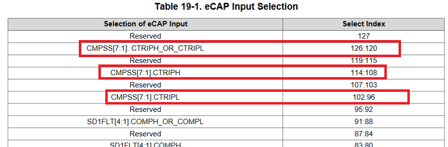

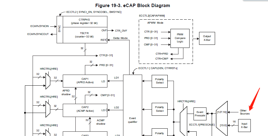

    2. I notice the source which come from 16 to 127 in Fig19-3 which shows ecap source. What mean "other source" represent? How to config these source if I want to use these for ecap function.
    Other sources from 16-127 are mentioned in Table 19-1 eCAP Input Selection Pg:2082 in TRM

  • Hi Manoj,
            I have some questions after I saw the Table 19-1.
            In the picture I sent, the ecap source could be chosen from red arrows. But, these source are not pins. Could I think pins of CMPSS could be used for cap function when I deploy related register rightly? If this thought was right, how should I deploy?
            Other question is shown in next picture.
            Could I think pins of CMPSS could be deployed as the function of epwm?
            Looking forward for your reply, and best wishes for you.

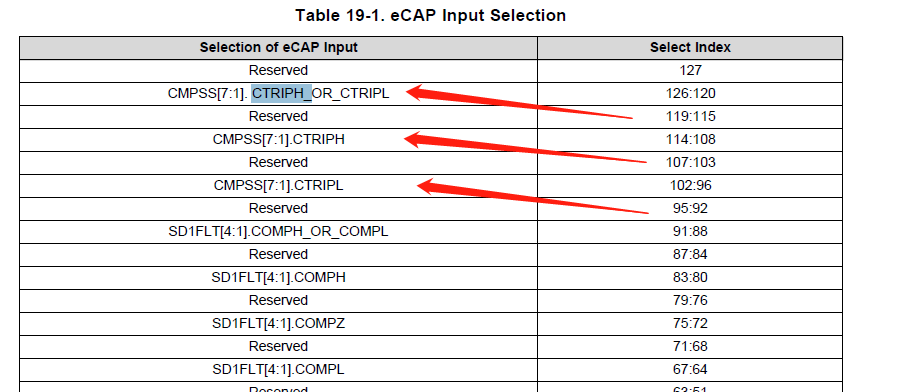

  • Coke,
    CTRIPH / CTRIPL are internal signals from CMPSS module to ECAP. These signals are not bonded out on device pins. Also, ECAP signals could not be chosen by the red arrows you mentioned. They have the chosen as shown below. The same argument applies to EPWM XBAR.

  • Coke,
    In your figure you attached, it looked as if 119:115 can be used to configure CTRIPH / CTRIPL. I wanted to highlight to you it is not the case, you need to use 126:120 to use CTRIPL / CTRIPH. If it is clear to you, please ignore the message.
    As I mentioned in the previos post,  CTRIPL / CTRIPH are internal signals (output of CMPSS signals) which go to XBAR. These signals are not accessible in device pins. You also don't have a way to directly connect CMPSS pins to XBAR. Please check the below diagram.

    • CTRIPL / CTRIPH signals in the diagram can be configured as trip input signals to EPWM module.
    • CTRIPL / CTRIPH signals in the diagram can be brought out on GPIO using OUTPUT XBAR.
