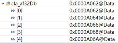

2. Using CCS to find structure and array address as below:

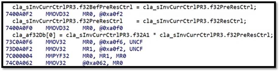

A. (Wrong result) cla_sInvCurrCtrlPR3.f32ResCtrl and cla_sInvCurrCtrlPR3.f32PreResCtrl are in adjecent address,Compiler generated instruction MMOVD32 here

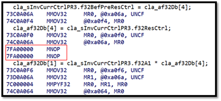

B. (Right result) replace cla_sInvCurrCtrlPR3.f32PreResCtrl with cla_af32Db[4] to make memery address none adjacent, Compiler generated instruction MMOV32 and inserted MNOP here.

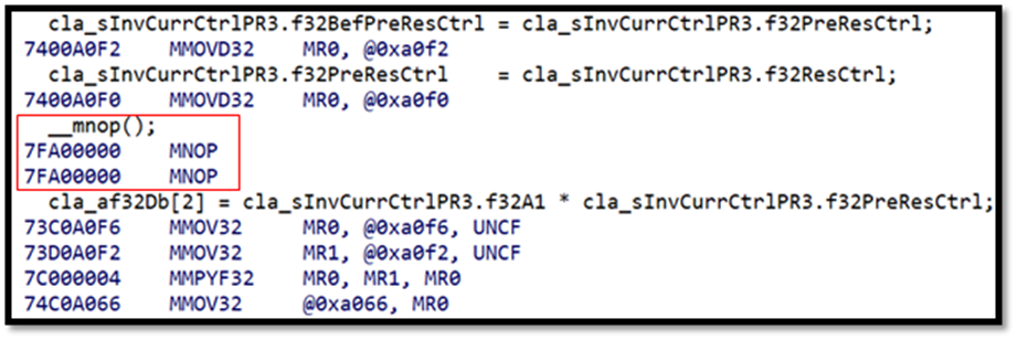

C. (Right result) Similar to "B", adding __mnop() in "A" to force MNOP here.
5. We assume instruction "MMOVD32 MR0, @0xa0f0" may need some time for @0xa0f2 to be updated, or @0xa0f2 will keep the old value to get the wrong result.

The issue is with MMOVD32 instructions. They do an extra data copy write to next address.
MMOVD32 MR0,mem1 ;
loads MR0: MR0=mem1
data copy: mem1+2=mem1
Any following instruction that reads from the same memory location (mem1+2) must wait for three instructions.
MMOVD32 MR0,mem1
MMOV32 MR1,mem1+2 ; too soon
MMOV32 MR1,mem1+2 ; good
