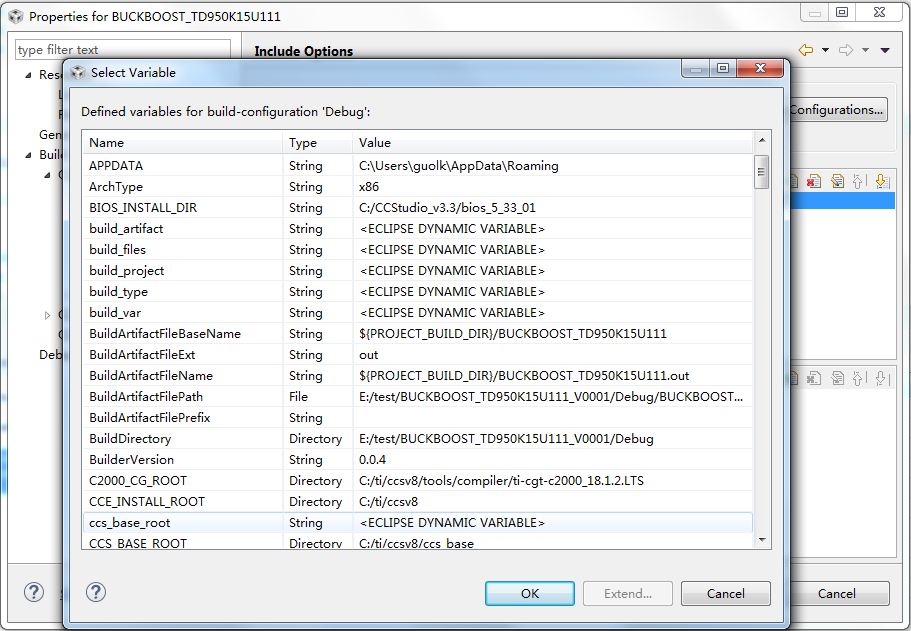

When build my project, gmake error. The console display as below:
Then I change the location of my project file, the console display the same error information. So I recheck the include option and file search path , the display as below:
Then I check linked resource, the display information:
My project location is E:\test,
Then check Defined variables for bulid-configuration dubug, can not find the file display in gmake error.
The cmd file locate in project/cmd.
Need suggestion, thanks.
  • I find the gmake error file path in subdir_vars.mk
    As Automatically-generated file, how can I edit the content of this file? Thanks.
  • Looking at the error message, it appears that CCS is trying to find/build the two .cmd files (DSP280x_Headers_nonBIOS.cmd and F28035.cmd) in the path mentioned in the message. Are they linked to the project from those paths? I also see both files are in the CMD sub-directory. Is it possible they are both added and linked to the project?
    If you could save the complete build log to a text file (as described in this page) and attach it here that would help to understand the source of error.
    According the console message, the mentioned path should linked to the project, but in   include option ,file search path or debug variable can not find how this path linked to project.
    I think the file in the CMD sub-directory should add in the project, according the include library files or command files. I exclude CMD sub-directory from build, the console display as below:

    gmake: *** No rule to make target 'E:/guolk/60Kw DCDCD 2.0/cmd/DSP280x_Headers_nonBIOS.cmd', needed by 'all'.
    gmake: *** No rule to make target 'E:/guolk/60Kw DCDCD 2.0/CMD/F28035.cmd', needed by 'all'.

  • ccs workspace\3\.metadata\.log
    !ENTRY org.eclipse.core.resources 4 275 2020-07-10 17:57:49.293
    !MESSAGE A resource exists with a different case: '/BUCKBOOST_TD950K15U111/Debug/cmd'.
    !ENTRY org.eclipse.cdt.managedbuilder.core 4 0 2020-07-10 17:57:58.383
    !MESSAGE failed to remove resources
    !SUBENTRY 1 org.eclipse.cdt.managedbuilder.core 4 0 2020-07-10 17:57:58.383
    !MESSAGE E:\test\BUCKBOOST_TD950K15U111_V0001
    !ENTRY org.eclipse.core.resources 4 275 2020-07-10 17:57:58.493
  • I see the following in your link command:
    -l"E:/test/BUCKBOOST_TD950K15U111_V0001/CMD"
    The -l linker option expects a library file name not a directory. In this case since you have specified a directory rather than a file, that is generating the "cannot open file" error. Please remove that value from the -l option list, and that should resolve that linker error.
  • AartiG,
    Thanks for your suggestion.
    I recheck my  -l option list, build complete.
    But I think the error message is puzzle, I think the file path in first picture have no relation with project .
    Why give this error message?
    Then I have two method to build the project.
  • First, I  recheck my  -l option and put the CMD files in project diectory
    Second, add CMD files in the file search path and exclude CMD folder from build in Project explore
    Then I find the output  file is different, the compare between the two map file
    Why have different output files? Need more suggestion, thanks.

    Then, I do more test, find something strange, recheck -l linker setting as below:
    build error, the only change the folder name from CMD to CMD1 as below
    build complete.
    Change the folder name for several times ,only find CMD build error, other name build complete.
    Why different  folder name lead to different build result? Can you give more suggestion, Thanks.

    In the build that fails, it is looking for the .cmd files in these directories:
    So there is some other difference between the two builds that is causing the .cmd files to be picked up differently in the two cases, but I don't know how the project is configured at your end.
  • The two build logs from one project , I just changed the folder, which contain the two cmd files, name from CMD to CMD1.
     I do not change any project configure or source code, only change the folder name.
    originalbuildlog.txt  from the folder name CMD, build fail.
    renamefolderbuildlog.txt from the folder name CMD1, build success.
    Could you give suggest about any other information i need provide about the project.
    Thanks for your reply.
  • Can you send me the three project metadata (.project, .cproject, .ccsproject) files inside the project folder for the project with the error? Please zip and attach it to this thread.
    ki
  • ki
    I have load the metadata.
    Either build error or build complete,I use only one project .I do not change any code or project configure, only change the sub-folder name which contain two cmd files.
  • Thanks. The metadata does not show anything interesting regarding the root cause...
    In one of your logs, I see:
    The "60Kw DCDCD 2.0" folder could be causing problems due to the whitespace characters in the name. Can you use a different folder name?
    ki
  • ki,
    Thanks for you reply
    The "60Kw DCDCD 2.0" is the initial folder name and 'E:/guolk/60Kw DCDCD 2.0' is the initial project location. Build error.
    Then change the folder name and project location, the above log file, either build complete or build error, from the folder name :"BUCKBOOST_TD950K15U111_V0001" and project location:"E:\test\BUCKBOOST_TD950K15U111_V0001".
    Neither project name nor the project location have whitespace.
    I change the project location for several times , have the same bulid error log infomation:
    so I think this build error relate to project configure, but can not find how to reconfigure the project to fix build error.
  • Project location and folder name of current project, have no relation with  'E:/guolk/60Kw DCDCD 2.0".
