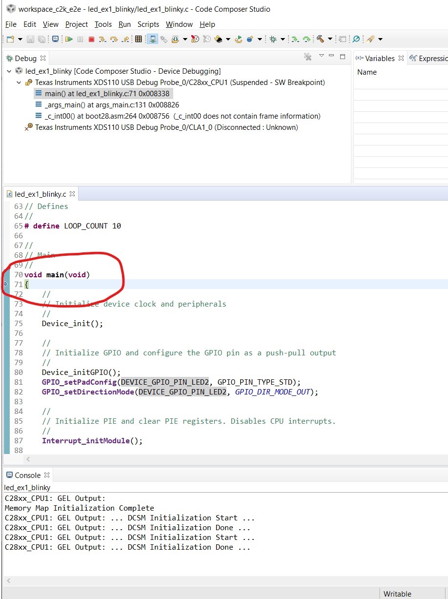

  • Eric,
    Eric_L said:
    When the program loads, does the program counter jump to main()?  -- Please clarify how to verify.
    When you start the Debug mode, CCS should automatically load your project and jump to main() in the source code.
    I tried the led_ex1_blinky example. This is what my project look like when I start my Debug session. Note that the program counter is in main().
    Eric_L said:
    But if I click Go Main in debug mode, then Step Into and Step Over are greyed out.
    If you were already at main() (see image above) and you tell CCS to "Go Main" from there, it will start program execution looking for main. Since there is an infinite "for" loop in the code, the program will never come back to main, CCS won't stop and the Step Into and Step Over will continue to be grayed out. You can click the Pause button at any time to stop the program, then you should see the Step Into and Step Over button become active again.
    Having said all this, there is a bug in the led_ex1_blinky example. It is toggling the wrong GPIO, hence you won't see any change in the LaunchPad. You can correct the code, rebuild it, and reload it.  The correction is simple: change DEVICE_GPIO_PIN_LED1 to DEVICE_GPIO_PIN_LED2. The corrected code is given below.
    Updated post: There is no bug in the LED example code. In fact, I was using the wrong build configuration for the project. To get the led_ex1_blinky example to work correctly you need to build the project with one of the LAUNCHXL configurations in CCS. To change the build configuration, from CCS, select Project -> Build Configuration -> Manage. Here you select the LAUNCHXL which executes from RAM or FLASH.
