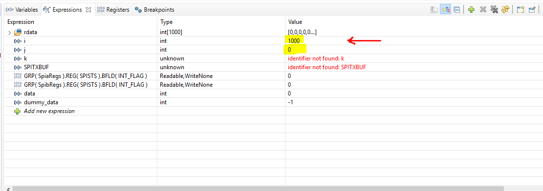

I write a code that transmit Data from SPI_A to SPI_B. I configure SPI_A in master mode and SPI_B in slave mode. When SPI_A transmission is complete the INT_FLAG in SPI_A set and interrupt occurred but in SPI_B data doesn't receive and INT_FLAG not set to 1, so the interrupt doesn't occurred. I configure SPI_A and SPI_B in non-FIFO mode.
How to fix this problem ?
Thank you for helping.

    Can you let us know the hardware connections you have made? Are you observing the data coming out of the SPIA pins(the CLK, STE, SIMO/SOMI)?

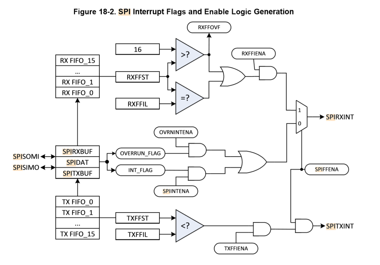

    Also, taking a quick look at your code, the transmitter isr 'isr_spia_transmitter' is mapped to the SPIA_RX_INT PIEVECT interrupt. Is it a typo or is that what you had intended?
    Praveen
  • Thank you for answer,
    I connect the SPISIMOA(GPIO58) to SPISIMOB(GPIO24), SPISOMIA(GPIO59) to SPISOMIB(GPIO25), SPICLKA(GPIO60) to SPICLKB(GPIO26) and SPISTEA(GPIO61) to SPISTEB(GPIO27).
    when I enable loopback mode in SPIA the RX buffer is correct so the signal comes out from master (SPI_A).
    Because I use the SPI in non-FIFO mode the Rx and Tx interrupt vectors in PIE block connected together  .( I attached the Datasheet )
    Do you have any code that setup SPI in slave mode and non-FIFIO mode ?
    I have a question, How to mentions other user for helping to answer questions ?
    Thank you.
