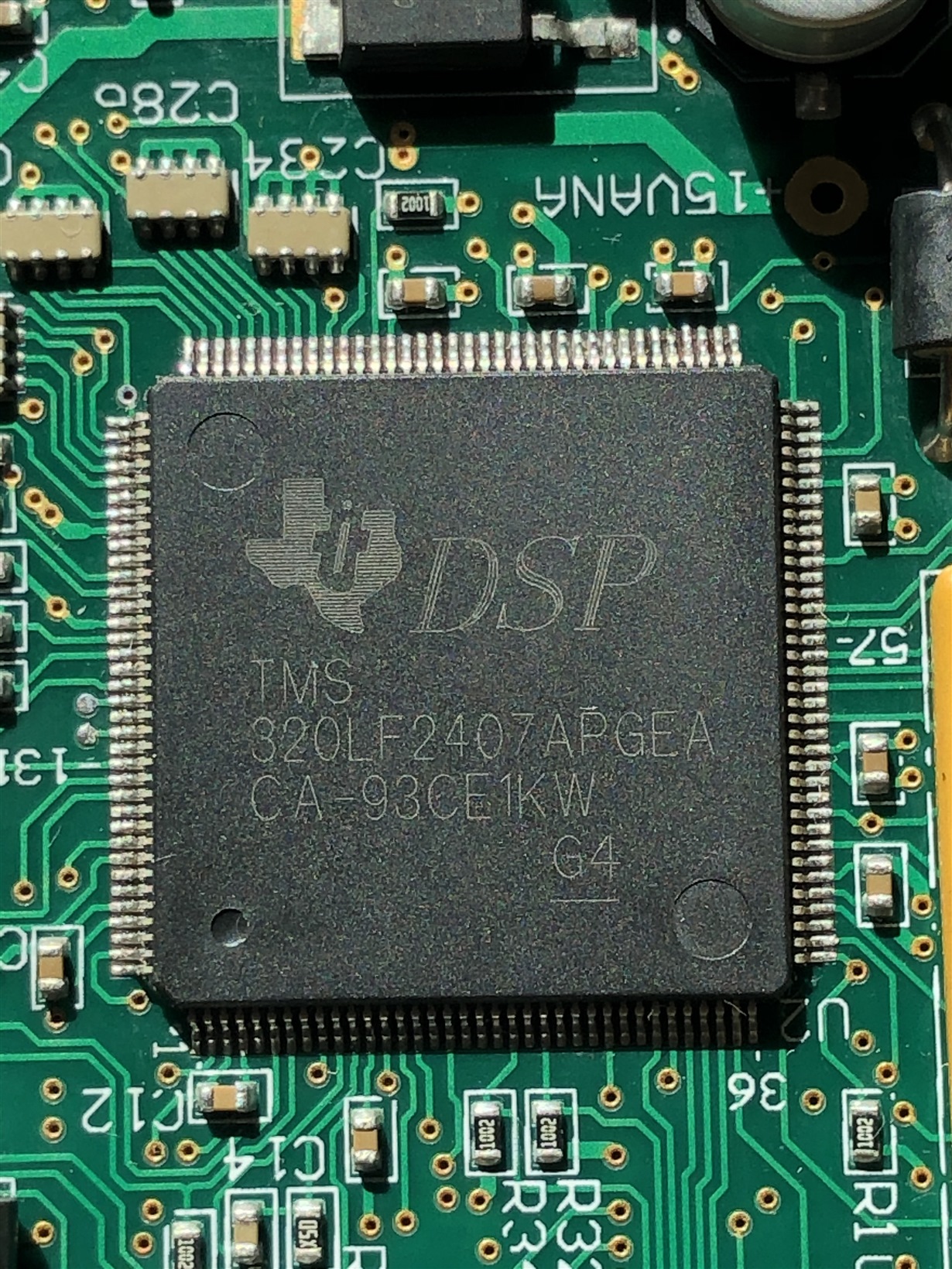

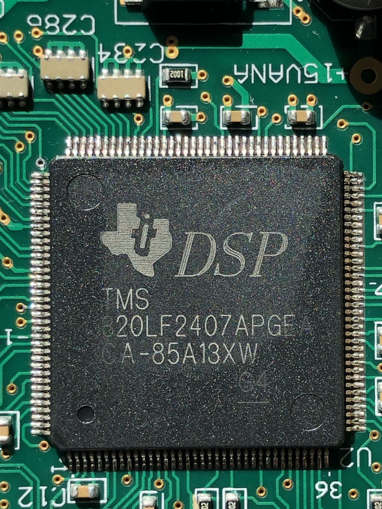

Good morning,
We have been using this TMS320LF2407 DSP for many years on one of our boards, several hundreds have been programmed without any issue.
On a series of 100 new boards, we are experiencing a high failure rate : 50% boards are rejected during programming :
Clear flash passes OK, but Erase flash fails, then programming process aborts.
Nothing has changed in the production process of the board, same BOM, same printed board, nothing has changed in the programming process, same tools used.
On some few boards, we have replaced the faulty DSP with a new one, then the programming process goes OK.

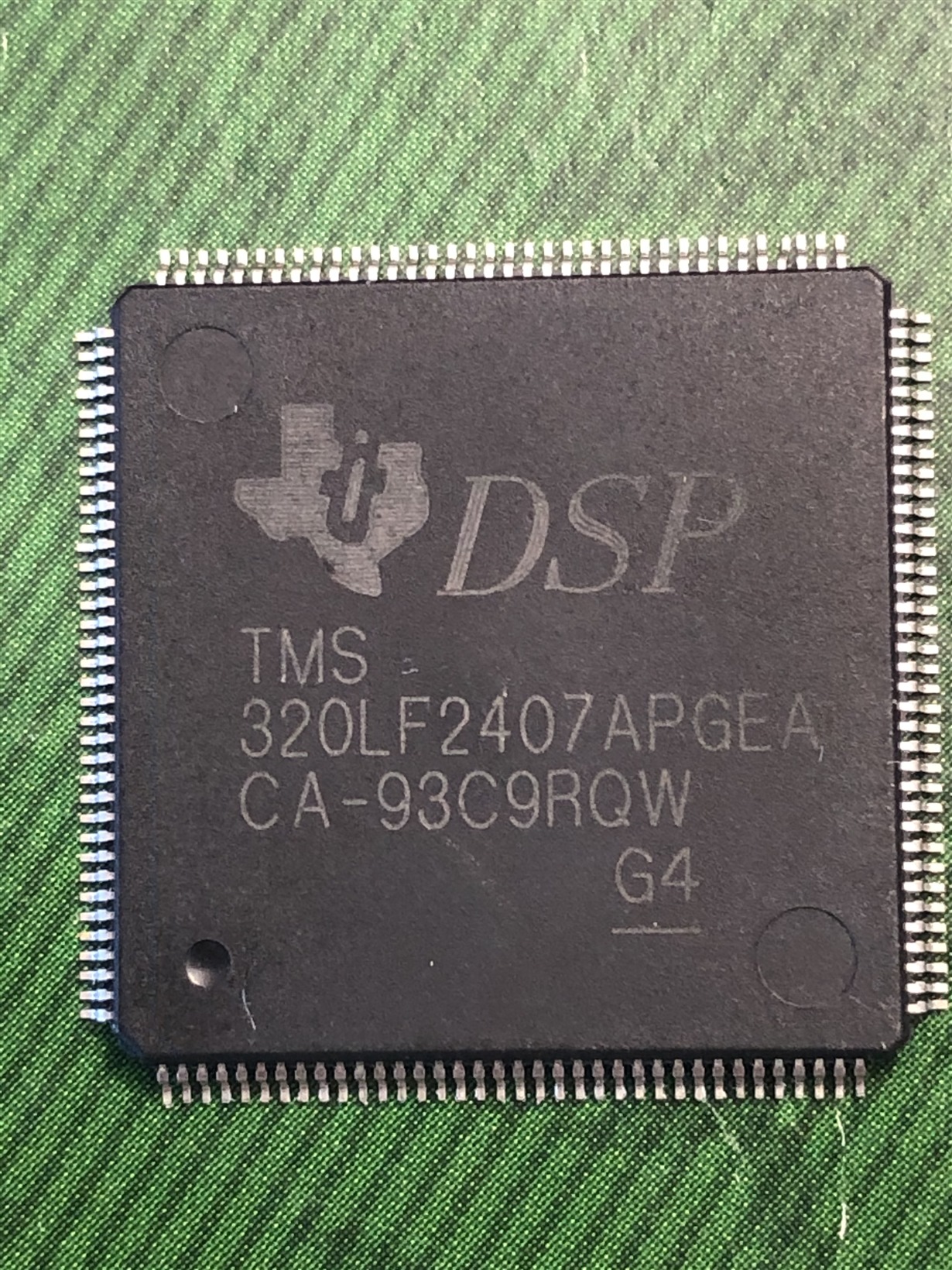

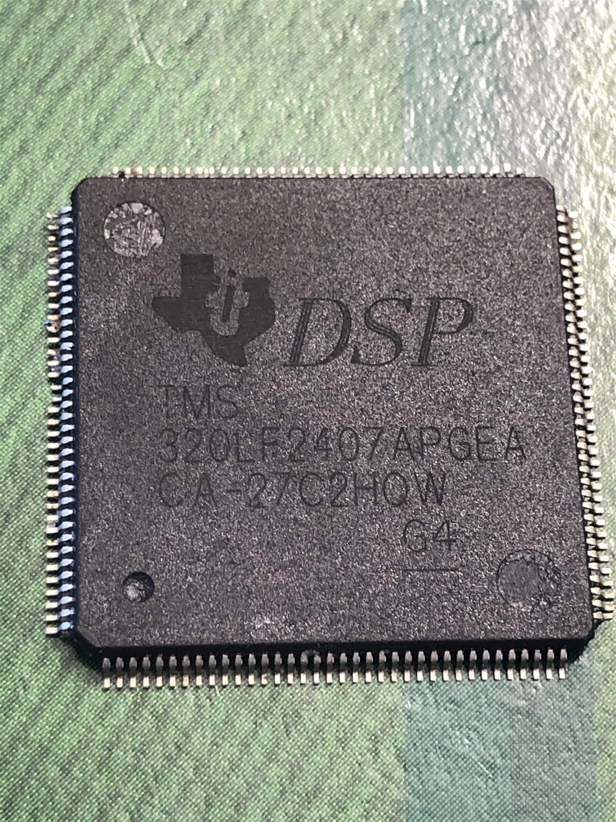

Did anyone experience same issues? some series of components? storage problems? counterfeit parts?...
Thanks for your returns
