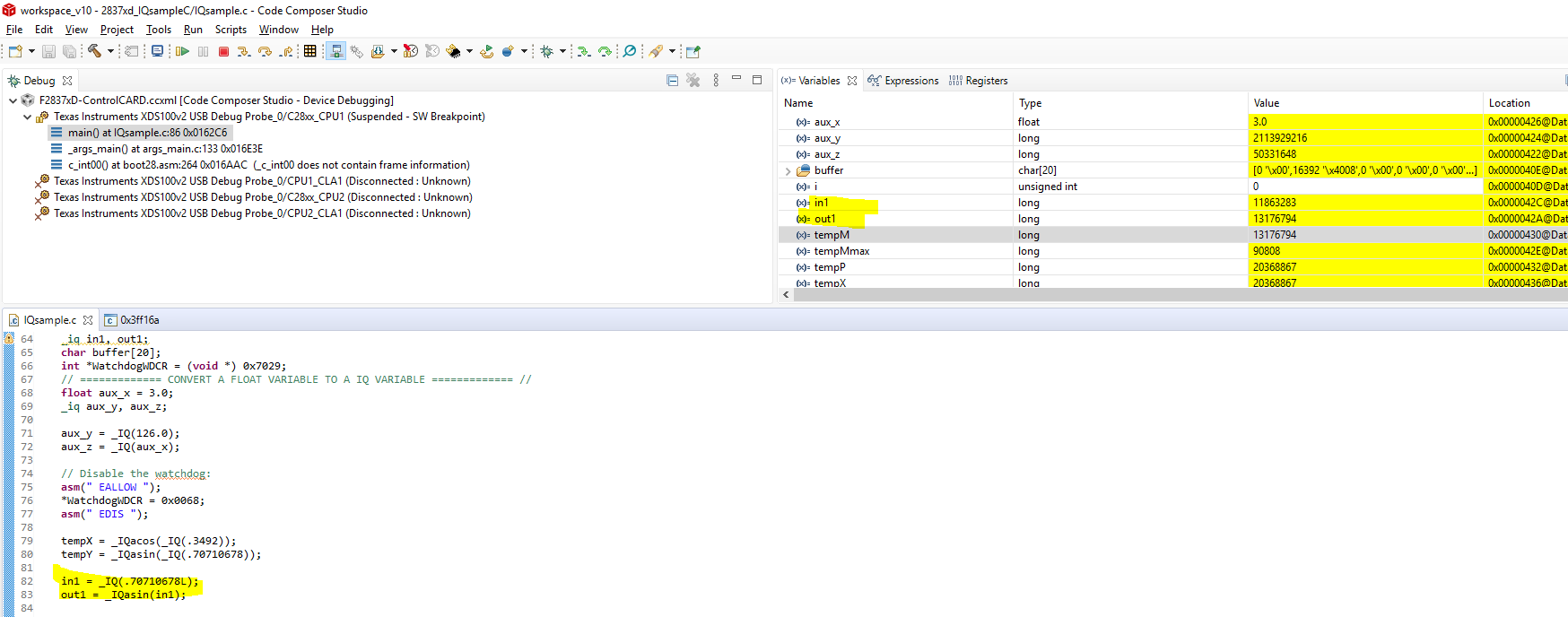

hi,
everyone,
my question is:
in1 =_IQ(0.70710678L);
out1 =_IQasin(in1);
in theory:
out1 = 0.25 * 3.14156
but when I use CCS V6 debug the formula :IQasin,it results :
out1 = -0.3131141663
why?
    Can you try the following and let me know what the result is:
    Value of in1
    The return value is supposed to be in IQ format. Can you adjust for that and get back to me?
    -Shantanu

    #define   GLOBAL_Q       24
    in1 =_IQ(1.0);
    out1 =_IQasin(in1);
    debug value:
    out1 = 2.309521794
  • I am assuming in1 is 16777216 ?
    out1 is expected to be in Q24 format right?
  • I ran the test on the F2837x using the project at C2000Ware_3_02_00_00\libraries\math\IQmath\c28\examples\C\2837xd
    and it works fine. See attached. The default Global Q is 24, so in1 corresponds to round(0.707.. x 2^24) and out1 corresponds to round(pi/4 x 2^24).
    thanks for your answer!!
    I have found the problem ,because of “F28035.CMD” file(I need to add IQmathTablesRam  SECTIONS) ,
    1、but i donnot know the relationship between IQmath_coff.lib and IQmath.lib?
    2、following is the cmd,and I donnot know Uncomment or   not uncommented ?
