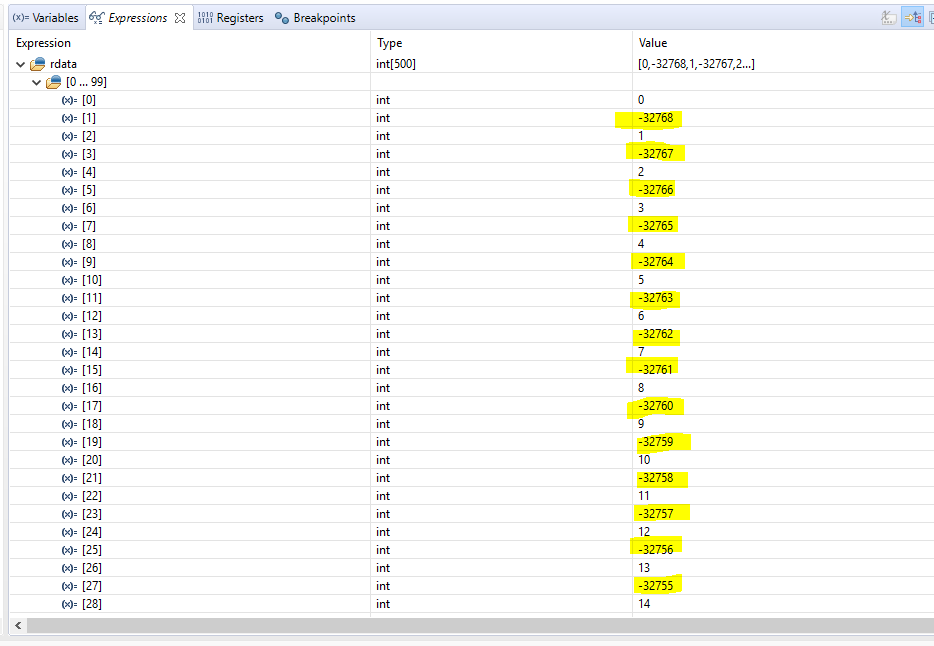

I write the code that sends data from SPI_A(master) to SPI_B(slave). According to datasheet the SPISTE pin in master before the start of transmission asserted to 0(low) by master and in  end of transmission asserted to 1 (high) by master. In the slave (SPI_B) for receive data the SPISTE pin should asserted to 0 (low). Now I have a question. I asserted SPISTE in slave (SPI_B) to 0 ( I connected this pin to GND of board) and in end of transmission keep this pin to 0 (low) and then sends next data. But the result is incorrect.
and now my question :
Is necessary that the end of transmission of word the SPISTE pin in slave asserted to 1 (high) ?
My code :

the result of received data when the SPISTE in slave (GPIO27) connected to SPISTE in master(GPIO61)
the result of received data when the SPISTE in slave (GPIO27) connected to GND :

    SPISTEA signal from SPI master will be pulled high every time the transmission is complete. But, since you have grounded SPISTEB signal there will be contention every  time transmission is complete. Depending upon your pull-down resistor on SPISTEBn pin, you might even damage the device pins because of this contention issue.
    Why do you want to ground SPISTEB pin? SPISTE signal is controlled by the master to show end of transmission. By grounding this signal you are prohibiting the SPI to show end of transmission this can affect the SPI internal state machine and cause unpredictable results like what you are seeing.
