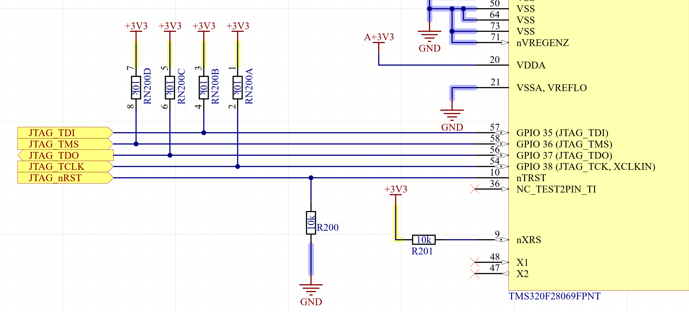

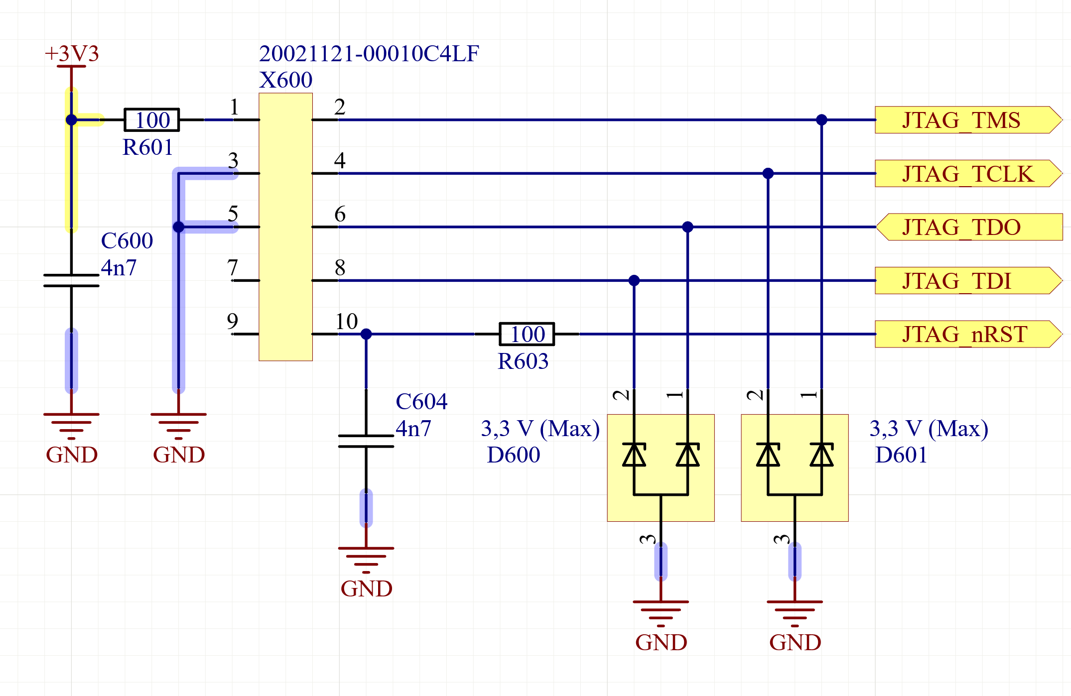

I have a weird problem:
I have here two custom boards, both with the same problem: They are still working and executing the latest program, but not programmable anymore (SC_ERR_BROKEN).
On both boards JTAG__TDO just keeps high... The MCU is still working with the latest program I flashed, but I can not program it anymore...
I tried the Wait Boot Mode, but still no success...
Do you have any ideas what went wrong or how to fix it ?
Attached is my schematic of the JTAG part.
