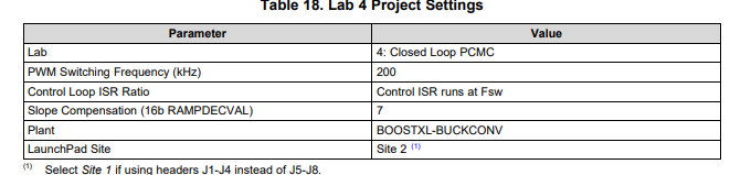

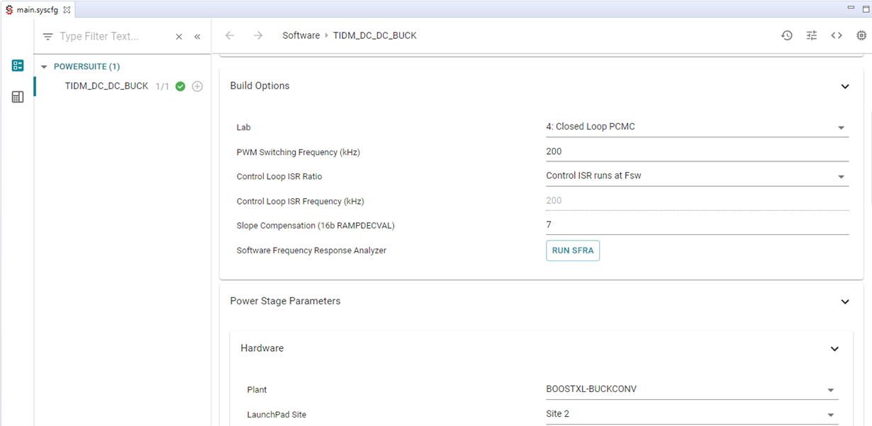

    Sure, here are the steps I follow:
    C2000 DPS BoosterPack Rev 2.1 is connected to LaunchXL-F280049C.
    I launch CCS 9.3.0 and import the buck_F28004x project from C:\ti\c2000\C2000Ware_DigitalPower_SDK_3_00_00_00\solutions\tidm_dc_dc_buck
    Followed by launching the configuration and selecting the Lab 4: for PCMC closed loop operation and launchpad site 2.

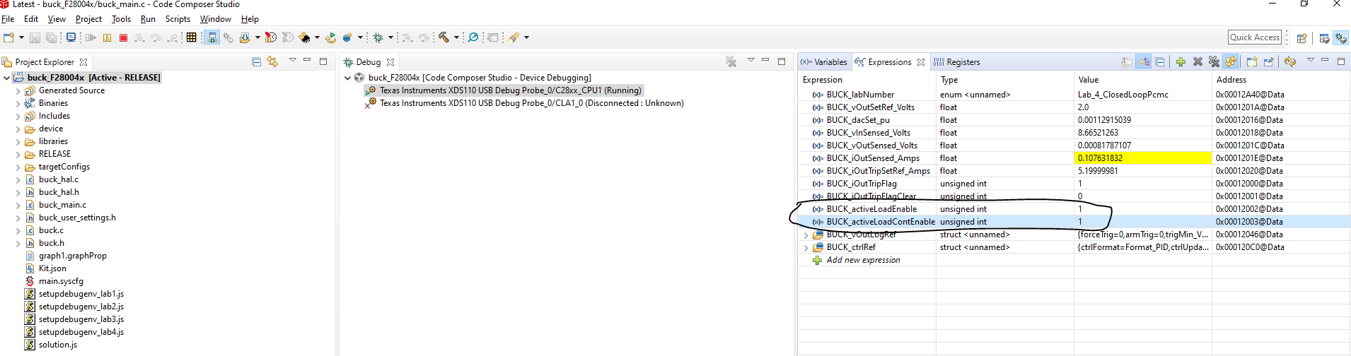

    Then I come to step 4, i.e enable continuous active load mode:
    The moment I enable the Active load as captured above, the sensed voltage drops to zero. I could see the waveform in DSO going to 0%DC for PWM-HI. Also we can see the Tirp Flag is set.

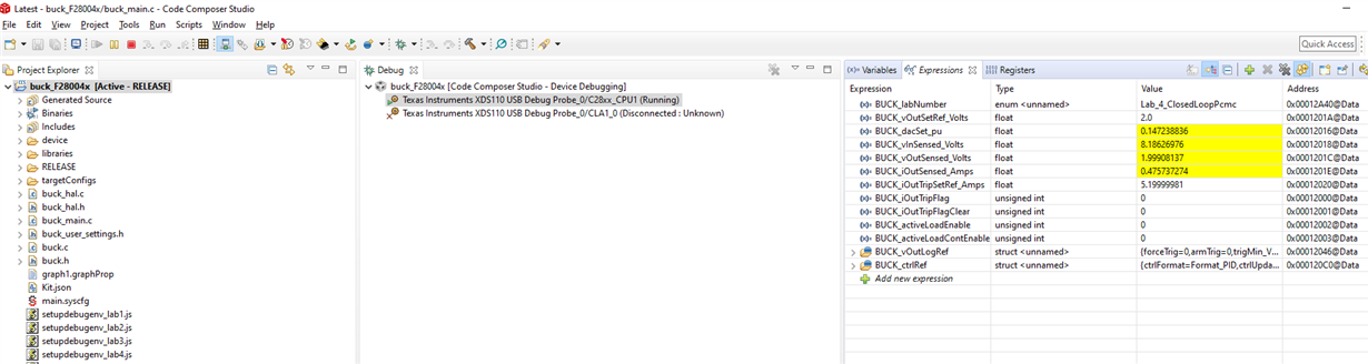

  • Hi Tommy,
    Thank you.
    Executing trip clearing sequence alone does not help. however increasing the Reference Amps threshold to 7.2A (Not even 7A helps) seems to make the difference. But the output voltage is not regulated properly. Sometimes the reading dips to 1.4V. Here is the snapshot of the same.
    Please let me know if this is expected observation? Meantime I will try to increase the current limit in MATLAB and see if I can reproduce this behavior.

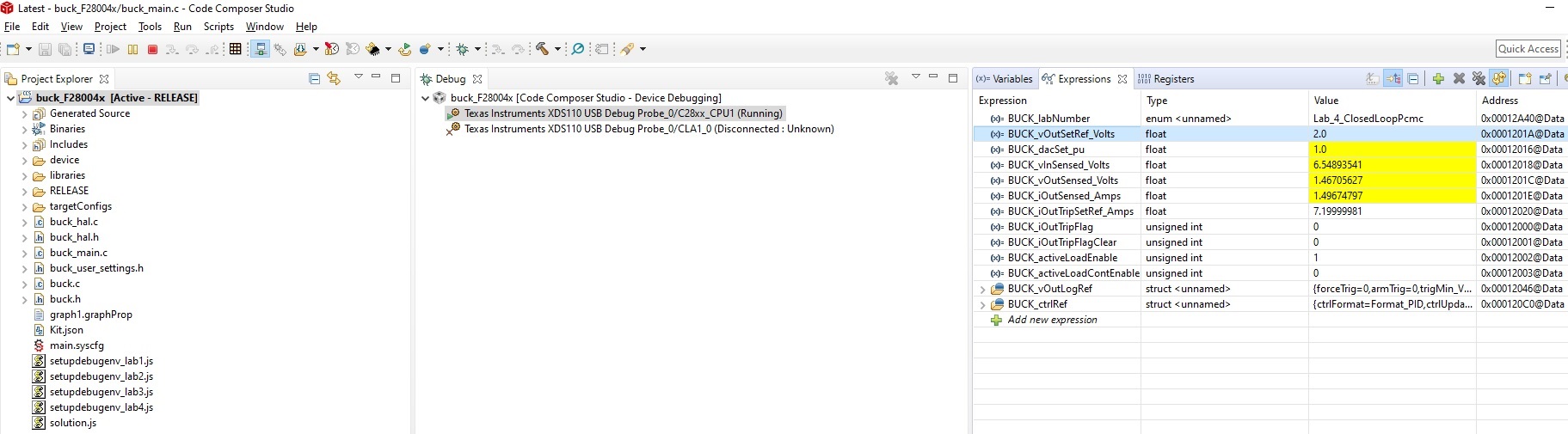

  • Hi Tommy,
    Setting BUCK_activeLoadContEnable on top does more harm than good. Are you suggesting that Active load should not be enabled when running PCMC. I am not sure why do i see different experimental results than what is claimed in the TI user guide.
  • Venkatesh,
    Both BUCK_activeLoadEnable and BUCK_activeLoadContEnable should be enabled at the same time.
    I see in your 1.47V screenshot that your BUCK_vInSensed_Volts reading is down to 6.5V.  Can you check your 9V DC supply to see if it is stable during operation?
