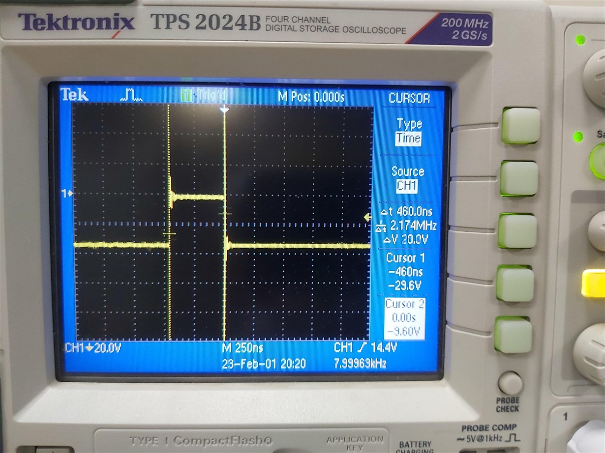

    I am using input and output variables of sin function in different section of RAM than ISR RAM in which i am using sin function.
    Still i am getting timing of 460ns, please see the below figure.

  • Sumanth,
    OK, I don't want us to get sidetracked into debugging other things. Let's focus on your issue. In your previous message, you said RAM: 3 + 63 cycles: 456nsec(observed from Oscilloscope). I made a measurement on the F28002x with the FastRTS library. The device itself shouldn't matter, since the C28xCPU+FPU is the same and we're running assembly. I measured 46 cycles, slightly more than the 38 cycles mentioned in the user guide.
    See attached picture.
