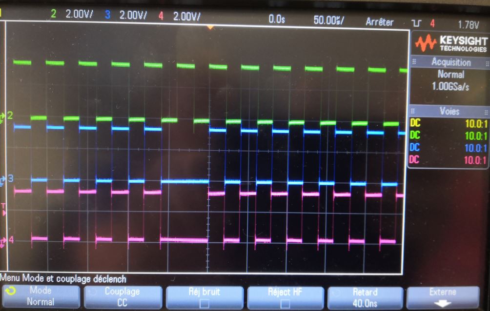

I try to realize a motor control in two motor with PWM.
In PWM signals, miss sometimes off phase.
Configuration description:
CPU at 200MHz
PWM initialization:
  • PWM1 Master in GPIO163 and GPIO164  (PHSEN = 0)
  • PWM2 Slave in GPIO165 and GPIO166_
  • PWM3 Slave in GPIO167 and GPIO168
  • PWM10 Slave in GPIO145 and GPIO146
  • PWM11 Slave in GPIO147 and GPIO148
  • PWM12 Slave in GPIO149 and GPIO150
PWM Period, 40µs with a Up-Down count mode. (TBPRD = 4000)
A dead-band is set to 1µs.
To have a small pressure point in a PSMS motor, the duty cycle are set around 50%:
  • PWM10, CMPA = 2040
  • PWM11, CMPA = 1980
  • PWM12, CMPA = 1980
Software execution:
After initialization (DSP, GPIO mux, PWM):
  • While (1) without interruption (Only a software loop)
Observation in oscilloscope in PWM10a, PWM11a and PWM12a.
Thank’s for your help.
