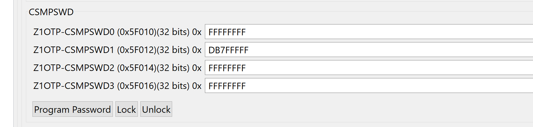

I have a locked device, which I am trying to “permanently” unlock by changing the LINKPOINTER. To do this, I have performed the following steps:
  1.  Put the device into Wait Boot Mode
  2. Unlock the device using the password.
  3. Start the On-Chip Flash
  4. Change the Zone 1 LINKPOINTER values from FFFFFFFF to FFFFFFFE
  5. Click the “Program LINKPOINTER” button
Steps 1 and 2 work fine, and I can see the correct contents of the secured memory.
Step 3 works
Step 4 works
Step 5 fails with a dialog box which says, “Error executing Flash operation “Z1LINKPOINTERProgram”: Unknown error”
Is there another step (or steps) which I need to add to make it work?
